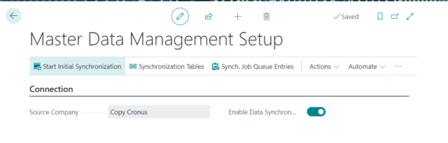

  • Prakash Krishnan
    July 18, 2023 at 10:16 am
    You can use recent feature of Master Data Management setup released in 2023 Wave 1 to copy master data from one company to other companies. You are required to setup tables and fields that you want to sync with other companies.
