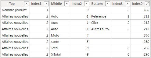

      I use a custom calculated table for the headerĀ
      Header =
      ADDCOLUMNS (
      UNION (
      DATATABLE (
      "Top", STRING,
      "Index1", INTEGER,
      "Middle", STRING,
      "Index2", INTEGER,
      "Bottom", STRING,
      "Index3", INTEGER,
      { "Nombre product", 1, "", 0, "", 0 },
      { "Affaires nouvelles", 2, "Total", 8, "", 0 },
      { "Affaires nouvelles", 2, "%Total", 9, "", 0 }
      SELECTCOLUMNS (
      SUMMARIZECOLUMNS ( Dim_Prod[dim5], Dim_Prod[dim6] ),
      "Top", "Affaires nouvelles",
      "Index1", 2,
      "Middle", Dim_Prod[dim5],
      "Index2", RANK.EQ ( Dim_Prod[dim5], Dim_Prod[dim5], ASC ),
      "Bottom", Dim_Prod[dim6],
      "Index3", RANK.EQ ( Dim_Prod[dim6], Dim_Prod[dim6] )
      "Index0", 100 * [Index1] + 10 * [Index2] + [Index3]
      OutputĀ

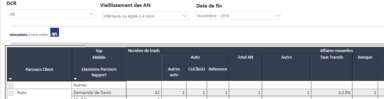

      The measure DimensionMeasure is calculated within the following script:
      DimensionMeasure =
      VAR a = SELECTEDVALUE(Dim_DateFicheAgent[ID_DateFicheAgent])
      VAR b =SELECTEDVALUE(Dim_VieillissementAN[ID_Tranche])
      RETURN
      CALCULATE (
      COUNTROWS(Fact_AN)
      Fact_AN[Vitesse_Transf_Mois]<=b;
      DATESBETWEEN (
      Dim_DateFicheAgent[ID_DateFicheAgent];
      NEXTDAY ( SAMEPERIODLASTYEAR (LASTDATE ( Dim_DateFicheAgent[ID_DateFicheAgent] ) ) );
      the measure DimensionMeasure returns wrong values, it’s almost the same value for all middle in the matrix:
      How to correct it?
