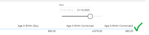

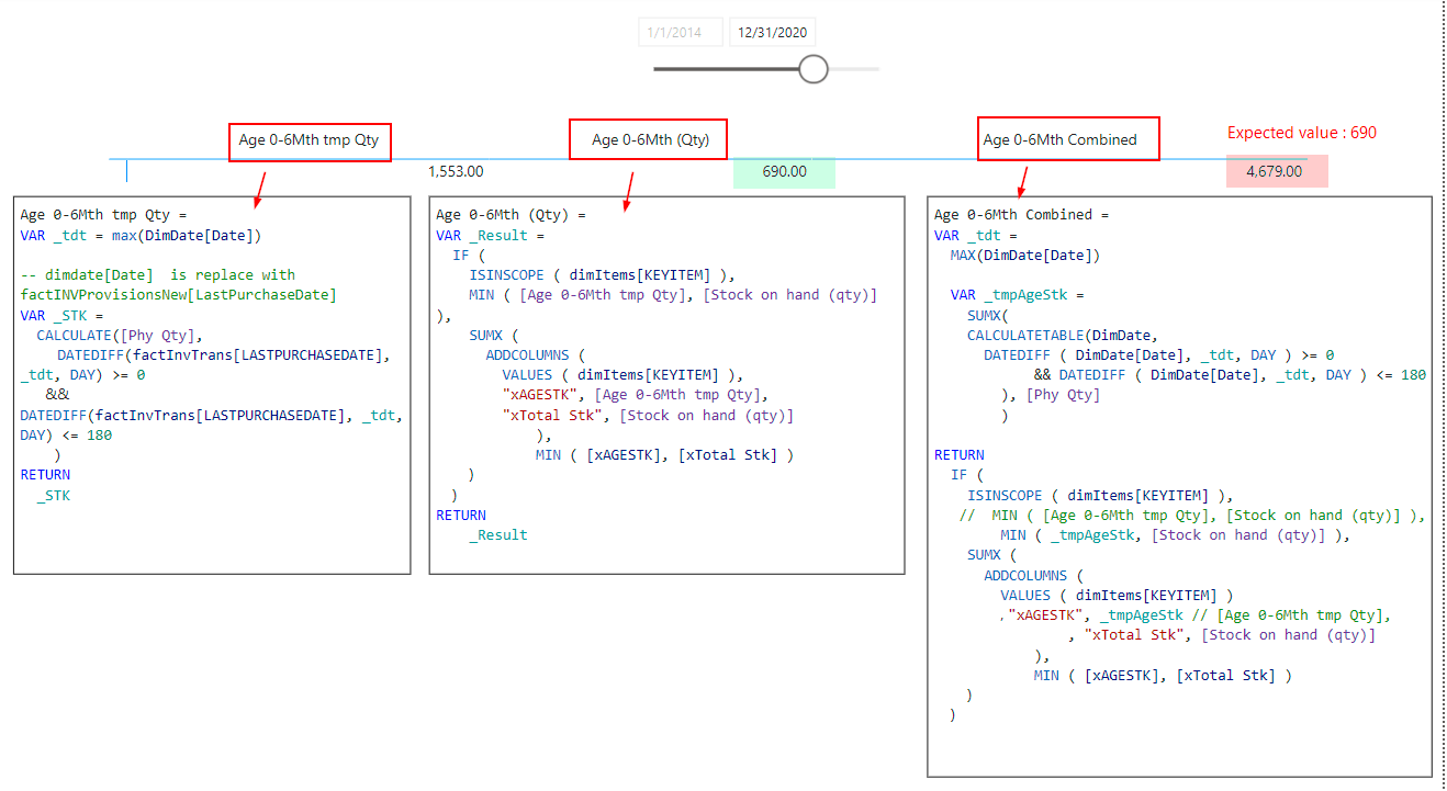

      i’m having a problem to calculate the AGING balance; However i have 2 measures to calculate my aging stock and works fine with expected result (690). Whereas i wanted to merge this into one measure and i’m not getting the correct values 690 instead of 4679
      Please help me, how can i get correct value (690) instead of 4679Ā

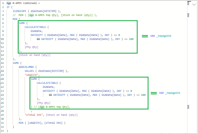

      Acho que não deu certo por que a variÔvel não altera por ser estÔtica. Troquei a variÔvel _tdt por MAX(DimDate[Date]), e a variÔvel _tmpAgeStk pela formula toda.

      May 17, 2022 at 4:01 AM
      Thank you Vilmar Santos
      very much and this is what i was looking long time and i got relived

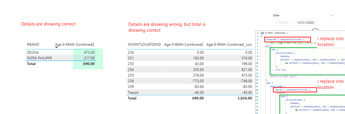

      I want to see by location wise then the calculation is showing incorrect; I don’t know where i’m wrong. Could you help this please
      i have uploaded the same fileĀ
