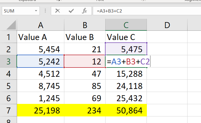

      Hi, Can we achieve “Value C” in Dax measures ?

    • Lutz Bendlin
      June 21, 2020 at 5:49 PM
      You need an index column.Ā  Once you have that, read the articles on the Internet about “previous row data”
      Lutz
    • John Thomas
      June 22, 2020 at 5:38 PM
      Hi Khurram –Ā
      As mentioned, if you can add an index column once your data is in the order you need it, you can then add a simple cumulative measure.
      Total Value A = SUM(‘Table'[Value A]??)
      Total Value B = SUM(‘Table'[Value B]??)
      Total Value AB = [Total Value A] +Ā [Total Value B]
      Cumulative Value AB =
      Ā  Ā  Ā CALCULATE( [Total Value AB],
      Ā  Ā  Ā  Ā  Ā  Ā FILTER(
      Ā  Ā  Ā  Ā  Ā  Ā  Ā  Ā ALL(‘Table’),
      Ā  Ā  Ā  Ā  Ā  Ā  Ā  Ā ‘Table'[Index] <= MAX(‘Table'[Index])
      Ā  Ā  Ā  Ā  Ā  Ā )
      Ā  Ā  Ā )
