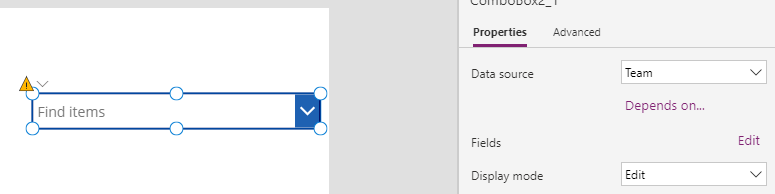

      Highlight the combo box, look in the drop-down at top left and select Items. The details will be in the box to the right of this. ?
      Warren Belz
      Queensland Australia
    • Mohan Srinivasamurthy
      November 18, 2020 at 1:40 AM
      Hi ,
      Thanks. Please see below.Ā
      Combo box – Connected to data source “Team” which is SharePoint list. This list has name and email address. I use “Email” header from this list which is of data type “single line of text”. This has list of email addresses to be selected.
      senior manager
    • Warren Belz
      November 18, 2020 at 2:27 AM
      What field in the list “team” are you displaying in the combo box?
      Warren Belz
      November 18, 2020 at 3:13 AM
      Hi ,
      I have fixed it and i am able to select emailids from comboĀ box and send mails as per your above suggestion. Thank you so much for yourĀ help.
      Note – “Team” SharePoint list has name and email address. I use “Email” field from this list to show in combo box.Ā
