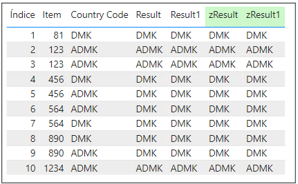

      Hello,Ā
      I have data table and data table contains item and country code. The item has duplicate entry and country code has unique entry against the item.
      The same item has more than one country code or sometimes any one of them. (DMK or ADMK)Ā
      Condition:
      If same item has more than one country code then first priority is DMK and second priority is ADMK. If there is no duplicate entry then return the available country code according to the item.Ā
      Result :
      Now, I want to get the unique country code based on the above mentioned condition.Ā
      I already created calculate column to get the desired result but I am looking for measure instead of calculated columns.Ā
      I am using the below mentioned formulas to get the desired result but I want the same result by using measure instead of calculated columns. (Both of them giving same result but I am trying to apply the same login measure but it’s not working)

      Veja se ajuda
      zResult =
      VAR Var1 =
          SELECTEDVALUE ( Data[Item] )
      RETURN
          IF (
              ISEMPTY ( FILTER ( ALL ( Data ), [Item] = Var1 && [Country Code] = "DMK" ) ),
              SELECTEDVALUE ( Data[Country Code] ),
              "DMK"
      zResult1 =
      VAR Var1 =
      VAR DMK =
          CALCULATE (
              COUNTROWS ( Data ),
      RETURN
          IF ( DMK > 0, "DMK", SELECTEDVALUE ( Data[Country Code] ) )
