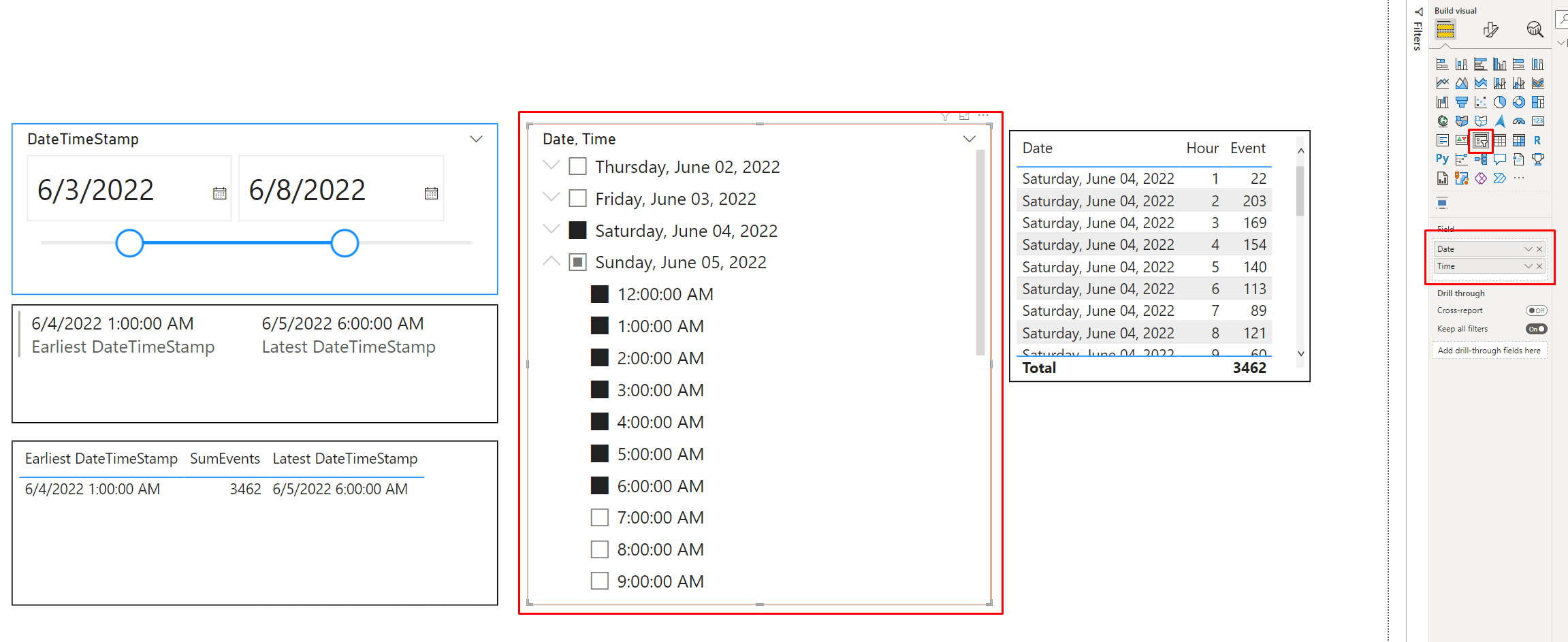

      As you haven’t received any good solution yet…..I can offer you a bit of a messy solution?
      It’s putting the Date and Time columns in the same hierarchy slicer and setting it as drop down.Ā
      Its a bit of a pain, but you can at least click your way to the desired time frame.Ā
      The sum of events is justĀ
      SumEvents = SUMX('Table','Table'[Event])
      The earliest DateTimeStamp and latest DateTime stamp, you can either set in your visual, or you could add measures
      StartTime = MIN('Table'[DateTimeStamp])
      EndTime = MAX('Table'[DateTimeStamp])
