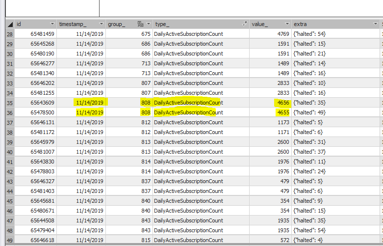

      I need a measure that sums all the max value_Ā  per (group_) per (timestamp_) where type_ = “DailyActiveSubscriptionCount” && timestamp_ = Today()
      Table = Statistic
      Columns = type_, timestamp_, value_, group_
      Notes = some group_ have multiple entries for the same timestamp_ with different value_ amountsĀ Ā

    • Christian ArltX
      November 22, 2019 at 9:55 AM
      I need it to sum the max value. Let me know if you know how to do that as some days have multiple entries for the same group_
