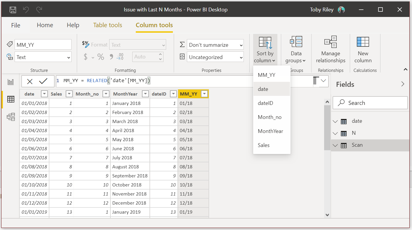

    • Tobias Riley
      April 28, 2020 at 10:53 AM
      Hi, Set the Sort By Column of MM_YY to date

    • Lutz Bendlin
      April 29, 2020 at 7:55 AM
      Use the “Sort by another column”Ā  feature with your Month Number column in your Dates table.

    • Dan Edwards
      April 29, 2020 at 10:11 AM
      Mohamed,
      I agree with everyone’s comments about using Sort by Column.Ā  The key to this feature is you need another column that matches up 1 to 1 with the column it is sorting.Ā  So looking at your data, make sure you use Sort by Column on the MM_YY column and sort it by the monthofyear column.
