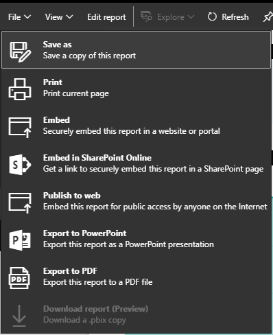

      The option for me to download the PBIX file is grayed out on the D365 Process Analyzer and Sales Analytics reports, which show in the normal reports area.

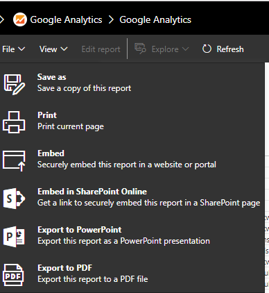

      The JIRA and Google Analytics reports only show up in the “Apps” section and do not have the “download a .pbix copy” option at all under File.Ā
      If I am not missing anything, and it is a limitation of the apps, then I will head over to the MS ideas site to suggest it.

    • Hasham Niaz
      June 20, 2019 at 8:23 PM
      For D365 Process Analyzer & Sales Analytics Reports, downloading is disabled.
      Your Power BI Admin has disabled reports download globally or may be download is only allowed to specific user group.
      You can check with your Admin guy, these setting can be found under;
      Settings -> Admin Portal -> Tenant Settings -> Export & Sharing Settings -> [Export Data]
      For [JIRA] & [Google Analytics] reports these are created from [Content Pack] / [App] so the source of the report is unavailable to you, it is only meant for consumption.
