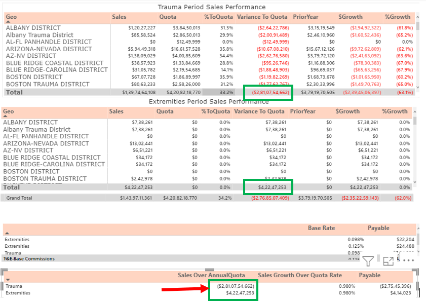

      Here in the sales over annual quota , Negative amount must return as zero for Trauma and same positive amount is already correct showing up under Extremities.
      I Tried IF Then Else logic (0+$4,22,47,253 =Ā  0) didn’t worked , will return sum of these two numbers as zero.
      As said ($2,81,07,54,662) as 0+$4,22,47,253 =Ā  $4,22,47,253 (Desired Output)
      Need help on other way of work around to build using Dax measure.

      Hi Sridhama,
      strange numbers you haveĀ  šŸ™‚
      What about SWITCH(TRUE(),[Variance to Quota]<0,0,[Variance to Quota])

    • sridhama Kundur
      May 29, 2022 at 5:15 AM
      Hi Adam,
      Thank You for your suggestion
      when I use switch dax function, am seeing total as zero..
      Total must be $4,22,47.253 right
      Need an dax measure to resolve this.

    • Dili Timor
      May 31, 2022 at 6:36 AM
      HI Sridhama,
      I think you should create dax measure for total sales-quota with calculate or sumx function then create measure (sales-quota-adjusted) again it to adjust 0 value for negative value.
      And than create matrix with trauma and extrimities as category and geo as sub-categories and (sales-quota-adjusted) for value. Than you can get total, grand total by fly

    • Nancy Peterson
      June 2, 2022 at 6:36 PM
      Hi . Have you tried something like this?
      Variance to Quota = IF( Ā Ā  [Sales]-[Quota] <= 0, Ā  0, Ā Ā  [Sales]-[Quota] )
