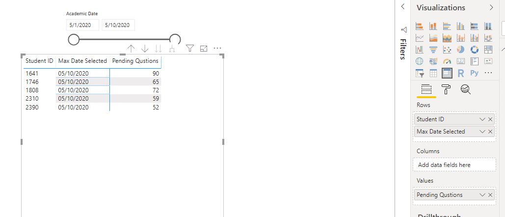

      Hi Team,
      I am trying to calculate sum of “Pending Questions” in Matrix Visual. Here I wanted to show “Student” and “Max date Selected” in row and sum of “Pending Questions” in value of matrix visual. File attached below.If someone could help me that would be great.
      Shailesh Kanse
      Senior BI Developer
    • Alberto Gastaldo
      July 8, 2020 at 3:11 AM
      HiĀ ShaileshĀ
      could you please clarify your request ?
      Do you need something like this ?
      StudendIDĀ  Ā  Max dateĀ  Ā Total
      1641Ā  Ā  Ā 10/05/2020Ā  Ā  Ā 90
      1746Ā  Ā  Ā 10/05/2020Ā  Ā  Ā 155
      1808Ā  Ā  Ā 10/05/2020Ā  Ā  Ā 227
      I attached the modified file with the correct measures:
      Basically I suggest you to:
      1) add a calendar table to your model: this is a best practice any time you play with datesĀ
      2) create a base measure that show the number of pending questions (i called it # of pending questions)
      # of pending questions = SUM(StudentPerformance[Pending Qustions])
      3) create a running total measure: what you need is basically REMOVE the filter on student and get the number of questions for all student less or equal to the current student
      # of pending running total =
      Ā  Ā Var currentStudend = SELECTEDVALUE(StudentPerformance[Student ID])
      Ā  Ā RETURN
      Ā  Ā CALCULATE(
      Ā  Ā  Ā  Ā [# of pending questions],
      Ā  Ā  Ā  Ā StudentPerformance[Student ID] <= currentStudend,
      Ā  Ā  Ā  ALL(StudentPerformance[Student ID])

    • Shailesh Kanse
      July 25, 2020 at 2:50 AM
      HiĀ Alberto,
      Thanks for your help. This is working for me.
