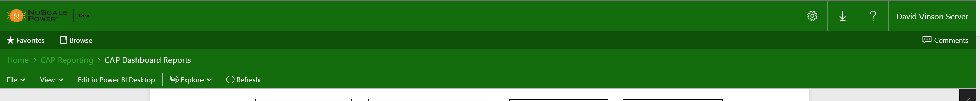

      On the server presentation, the multiple ribbons (for navigation, headers, etc. ) take up a ton of space.
      Is there any way to minimize them? Remove them? Make them smaller?
      In a perfect world, I’d eliminate all of them when the report opens.
      Any help would be appreciated.

      Hey,
      Open up the report and add this to the end of the URL
      ?rs:embed=true
      cheers
      Ben

      ?Ben!!!!
      You are a lifesaver.
      Thanks. This is perfect
