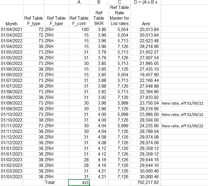

      I need the cost to be computed based on the rate between start and end period of each change against F-Data and F_Type.
      Attaching the file
      FA

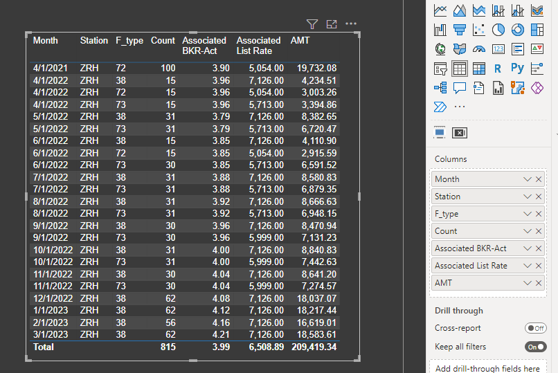

      Hi James, This is the required output to achieve
      1) A simple calculation = F_cont x BKR (exchange rate) x Rates (Rate against F_type & F_cont)
      2) You will notice the rate is getting changed eff 01/9/22 and a new rate will be applied to F_type.
      In simple, the amt to be calculated based on prevailing rate against F_type & F_cont
      FA

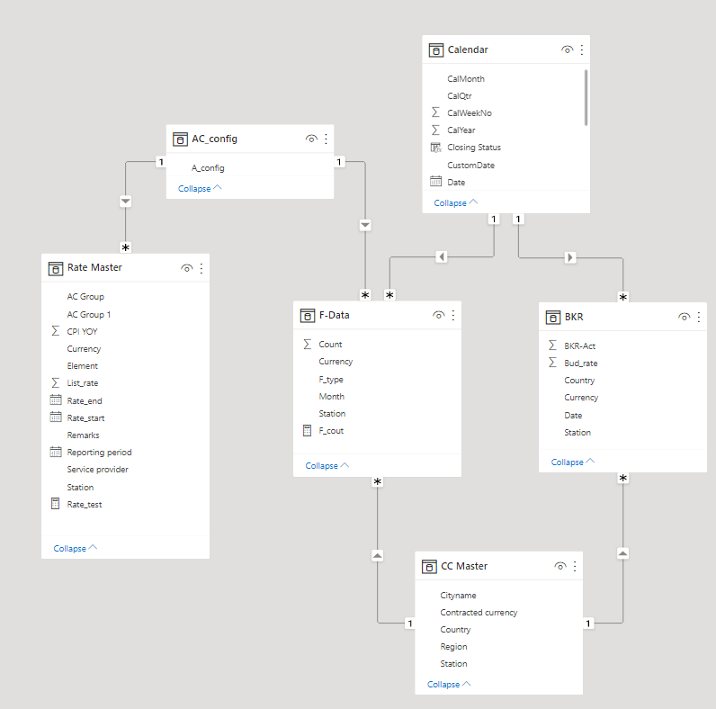

      I took a look at your .pbix file, and I’ve got a few suggestions for you.
      First, I would simplify your data model, so that it looks like the picture below.Ā  Eliminate the many-to-many relationships, and any bi-directional relationships.Ā  I don’t think you really need them.

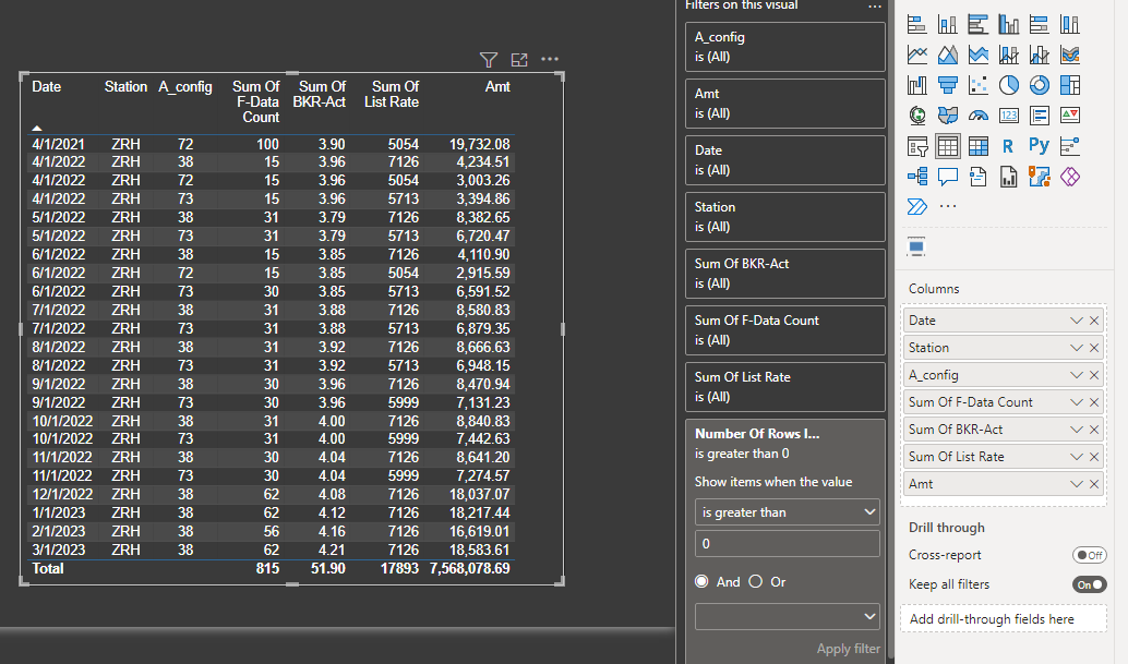

      Then, in order to create the table you described above, I would create several different measures.
      1. First for the column you marked as “Ref Table F_cont”, I created a measure called “Sum Of F-Data Count”, that simply looks like this:
      Sum Of F-Data Count = SUM('F-Data'[Count])?
      2. Next, for the column you marked as “Ref Table BKR”, I created a measure called “Sum Of BKR-Act”, like this:
      Sum Of BKR-Act = SUM(BKR[BKR-Act])?
      3. For the column you labeled “Ref Table Rate Master For List Rates”, I created a measure called “Sum Of List Rate”.Ā  This one is a little more complicated because you grab only the values of List Rate that are appropriate for the date that is showing in the current filter context.
      Sum Of List Rate =
      VAR _currentDate =
          MIN('Calendar'[Date])
      RETURN
          CALCULATE(
              SUM('Rate Master'[List_rate]),
              _currentDate >= 'Rate Master'[Rate_start],
              _currentDate <= 'Rate Master'[Rate_end]
      4. And then for the “Amt” column, I simply created a measure to perform the math you described:
      Amt =
          DIVIDE([Sum Of F-Data Count] * [Sum Of BKR-Act] * [Sum Of List Rate], 100)?
      5. Finally, in order to create the table you show in your last post, we need to limit the dates we show to only those where there is data contained in the F-Data table.Ā  To do this, I created a measure called “Number Of Rows in F-Data”, and I use this measure as a filter for the visual.
      Number Of Rows In F-Data = COUNTROWS('F-Data')?
      And the resulting visual looks like this:
      Now, my math did not seem to work out the same as what you posted in your last post, but I know the values I have are based on the data from your .pbix.Ā  Since you understand your data better than I do, perhaps you can figure out where I went wrong.
      I’m attaching the .pbix file for your review.

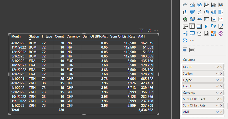

      September 10, 2022 at 9:48 AM
      Posting a new pbix file, where you will notice, the AMT is not calculated because of missing BKR.
      I would like to repeat the last available BKR rate, where rates are not available against stations
      NOTE – Avoid sum for coloumn ExcH rate & Rate

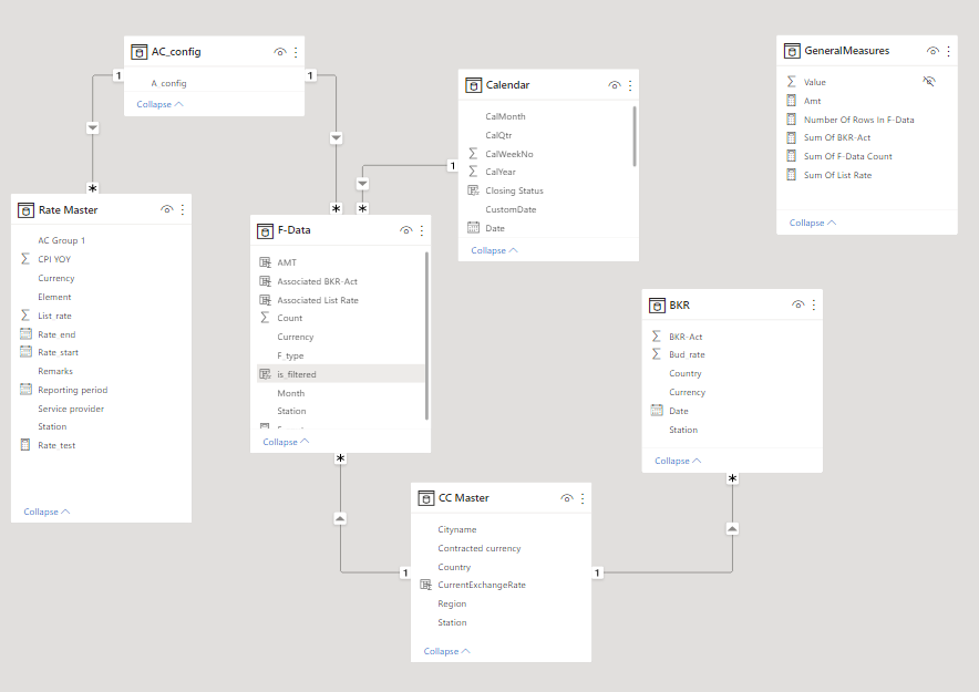

      In order to get rid of those totals for the Exch Rate and Rate columns, you will need to revert to the using measures in the table-visual rather than the calculated columns.Ā  We will still use the calculated columns to arrive at the AMT value, but you will use the measures for the table-visual.
      And in order to get the Exchange Rate to pick up the latest available exchange rate associated with a given date, you will need to take two steps.
      First, you need to disconnect the BKR table from the calendar table – that relationship does not really exist in your data model.Ā  (and, frankly, you might not need the calendar table at all – it does not seem to serve any purpose in this example).Ā  Now your data model will look like this:
      Next, re-write the Sum Of BKR-Act measure, so that the formula looks like this:

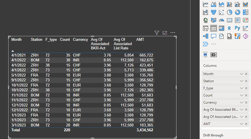

    • Kaz Shakir
      September 11, 2022 at 5:05 PM
      I had the file open on my desktop today, and noticed that I gave you some bad advice in my last message.?Ā  My apologies.Ā
      Since we have created the new calculated columns, and they work well, we can actually just reference those in the measures – that way we are not duplicating those calculations, which will make it easier to maintain in the future (if the calculation were to change, you would only need to change it in one place).
      I would create two new measures: one to calculate the average of the “Associated BKR-Rate” column, and another to calculate the average of the “Associated List Rate” column, like so:
      Avg Of Associated BKR-Act =
          IF(
              ISFILTERED('F-Data'[Month]),
              AVERAGE('F-Data'[Associated BKR-Act]),
              BLANK()
      Avg Of Associated List Rate =
          IF(
              AVERAGE('F-Data'[Associated List Rate]),
              BLANK()
      note: the IF statement and the use of the ISFILTERED condition is so that the measure returns a blank on the total row.Ā  If you just use the Average function, then you will get a value on the total row.
      You would still use these measures the same way as before:
      Hope that helps.
