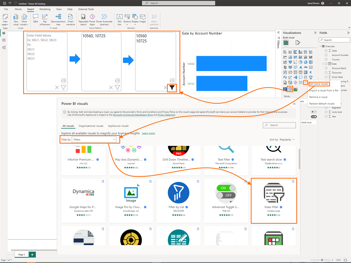

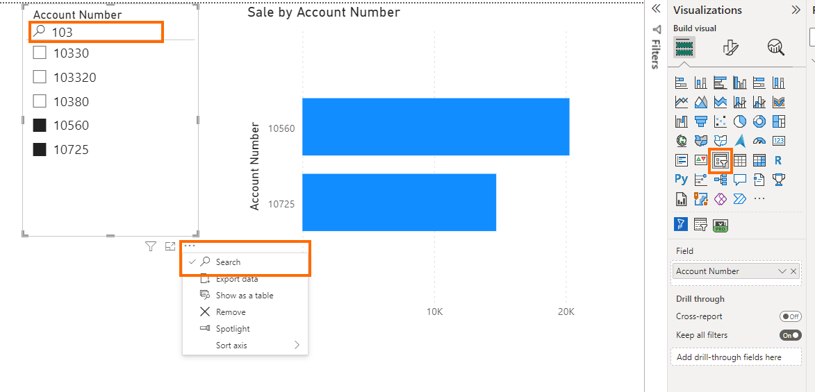

      The Power BI Slicer visual does have a Search option that can be enabled for text fields in the visual header (as shown below), though it only allows filtering the slicer list based on one value at a time (i.e. users couldn’t paste in a comma separated list as I imagine would be ideal in your situation).Ā Ā
      There are however several third-party visuals that allow you to do just that if your organization allows. One that I just tried seems fairly simple to use and robust based on my quick assessment is the “Mass Filter” certified visual by Insiders.Ā  The “Filter by List” visual from DevScope was a close second, but it didn’t handle pasting in multiple lists quite as well and didn’t remove duplicates.Ā
      Ā I hope this helps, let me know if you have any questions.
