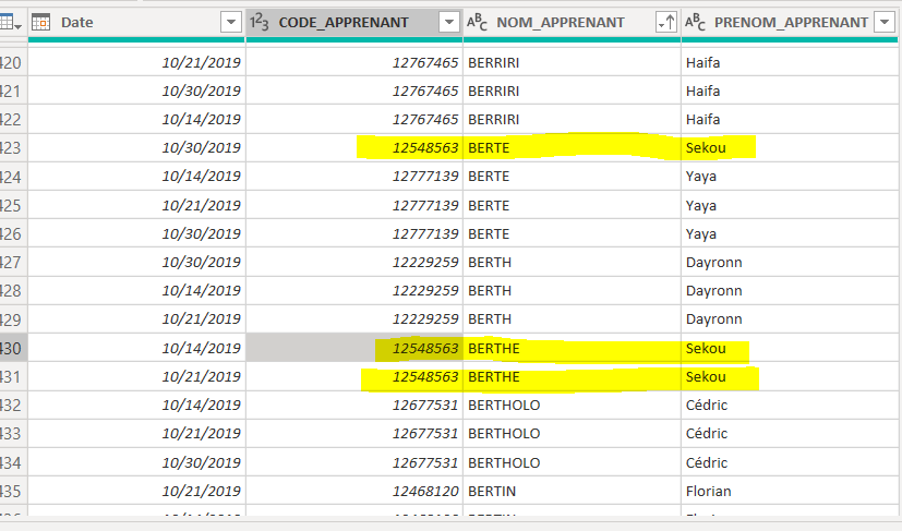

      I have attached your file with two possible solutions.
      One uses the Query Editor to group the data set and get the min and max dates.
      One uses a DAX calculated column to do basically the same thing.
      One problem is that they produce slightly different numbers.
      I traced that out to an issue in your data, where one person has the last name spelled differently.Ā
      This will make the Query Editor method incorrect, as it uses the last name as part of the group by.
      The DAX calculation uses the Code_Apprenant column to do the grouping.
      Let me know if you have any questions.
