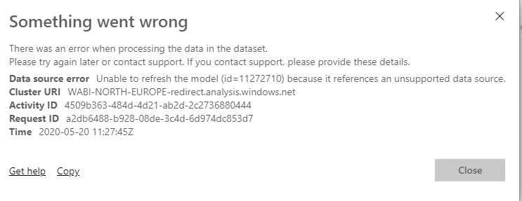

      I build a report in Power BI desktop where source is JIRA Cloud. I am able to refresh in Power Bi desktop but when I trigger a manual refresh, it gives me an error message given below –Ā
      Data source errorĀ Unable to refresh the model (id=11272710) because it references an unsupported data source.

      With this I am successfully loading 45K+ rows in Power BI desktop but when I published this is giving me an error mentioned above.Ā

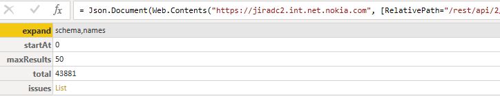

      Understanding from blogs that may be some query is not recognized by Power Bi service, I tries below with Relative Path as well –Ā
      let
          Source = Json.Document(Web.Contents("https://jiradc2.int.net.nokia.com", [RelativePath="/rest/api/2/search?jql=project%20in%20(NEO1,NEO2, NEO3,NEO4,NEO5,NEO6)%20AND%20issuetype%20in%20(Epic,SAFe_Solution_Epic,SAFe_Capability,Improvement,Story,%22New%20Feature%22)%20AND%20created>%3D2017-01-01&fields=customfield_41593&fields=customfield_12157&fields=updated&fields=resolutiondate&fields=lastViewed&fields=duedate&fields=created&fields=versions&fields=summary&fields=priority&fields=components&fields=comment&fields=assignee&fields=subtasks&fields=status&fields=resolution&fields=reporter&fields=project&fields=issuetype&fields=fixVersions&fields=creator&fields=labels&expand=changelog"])),
          issues = Source[issues],
          #"Converted to Table" = Table.FromList(issues, Splitter.SplitByNothing(), null, null, ExtraValues.Error)
      in
          #"Converted to Table"?
      Ā Ā
      With this query I managed to refresh on Power Bi service but now I am getting only 50 rows instead of ~45K. Even if define maxResults to 10000, it gives in return only 1000 rows as it is a defaul behaviour of JIRA.Ā
