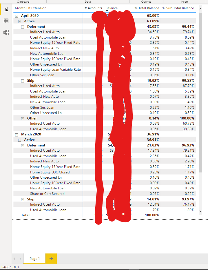

      Trying to calculate the percent of total so that when I filter the table to show just one month, the totals recalc up to 100% . Current if I filter the table to be just April, my %Total Balance stays at 63%

      It works, but it isolates the totals to each month, so march totals up to 100% and April Totals to 100%. When showing 2 or more months, I want each month to be the percent of the displayed total. Any ideas how to do this better or what I’m missing?

      Ok so I may have made a mountain out of a ant hill, when clearly the built in show value as % should do what I wanted. But if anyone wants to take a crack at cleaning up my DAX or solving the original question via DAX i’m always looking to expand my DAX code library

      I think you will want to use the ALLSELECTED command, so you can get share based on your filtering. I have included an example. I hope this helps.

      an idea how to take it a level deeper and get the sub totals?Ā
      This is what I have today:
      % Sub Total Balance = divide([Total_Balance],LOOKUPVALUE(Sub_Totals[Balance],Sub_Totals[Subtotal_Key],SELECTEDVALUE(Skip_Deferred_Payments_Reports[Subtotal_Key])))

      It is in a matrix already, so i must be missing something with the sub-total you referred to, I couldn’t find a way to get indirect autos to show as a percentage of the deferment total vs the overall total… I got a solution, i think i could have done it with table variables but couldn’t figure out how to reference the table variable columns correctly, so i gave up and created 3 calculated tables instead. and just added a switch to control the lookup statment
      % Sub Total Balance = SWITCH(TRUE(),
      [ActiveFilter]=0
      ,divide([Total_Balance],LOOKUPVALUE(Sub_Totals_Combined[Balance],Sub_Totals_Combined[Subtotal_Key],SELECTEDVALUE(Skip_Deferred_Payments_Reports[Subtotal_Key])))
      ,[ActiveFilter]=”Active”
      ,divide([Total_Balance],LOOKUPVALUE(Sub_Totals_Active_Only[Balance],Sub_Totals_Active_Only[Subtotal_Key],SELECTEDVALUE(Skip_Deferred_Payments_Reports[Subtotal_Key])))
      ,[ActiveFilter]=”Expired”
      ,divide([Total_Balance],LOOKUPVALUE(Sub_Totals_Expired_Only[Balance],Sub_Totals_Expired_Only[Subtotal_Key],SELECTEDVALUE(Skip_Deferred_Payments_Reports[Subtotal_Key])))
