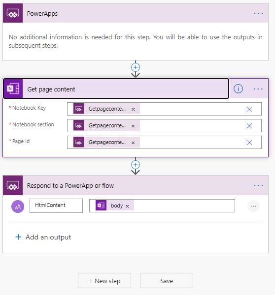

      Hi Alaa,
      No. šŸ™‚
      The only way I could make the connector work was by offloading that particular function to Power Automate:
      On the PowerApps side, I used the three dropdowns setup described here: https://powerusers.microsoft.com/t5/Building-Power-Apps/How-to-find-OneNote-Notebook-key/td-p/126477. Slight tweak: Section ID you need to use pagesUrl to return a working value, but you probably know that already.
      It seems like the connector has a problem on the PowerApps side, because it’s clearly getting something it’s not expecting, but there isn’t a way around that within PowerApps that I can see.
      My cursory research suggests parsing JSON objects is not natively possible in PowerApps alone – everyone seems to be offloading to flows or writing convoluted custom functions to dodge around the offloading. So, even if it’s returning JSON, and it needed to be parsed, PowerApps isn’t equipped for the job.
      I think. šŸ™‚ Big grains of salt though.
