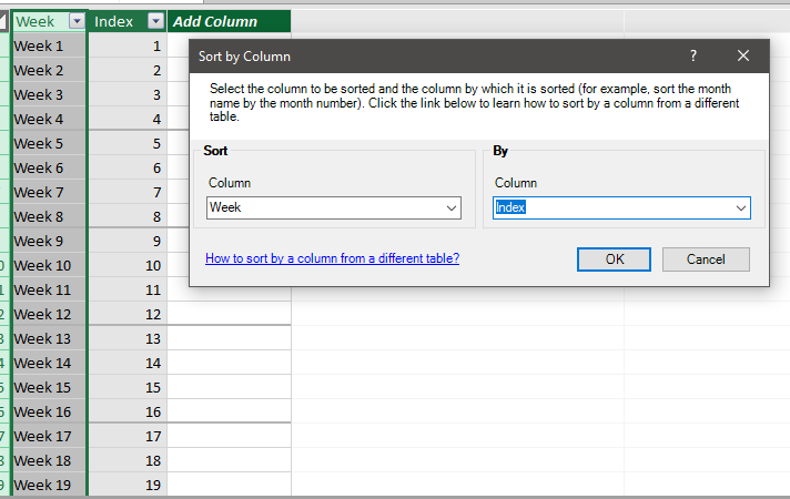

      Hi May Leese,
      Use the “Sort by column” feature in the ribbon. Basically, you sort one column by another. In one column you list your weeks, and in a second column you list the order in which you want your list to show up.
      Hope that helps. Let us know

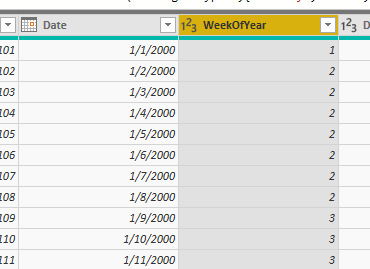

      A couple of questions: Is your date column formatted as a date or is it a text field? If it’s text, then it will not sort properly on it’s own. Are you using a date table in your model? We use a custom date table in all of our data models to be able to control the X axis in many ways.
      I typically use a text value in my X axis to display months (e.g., Jan-2019) and have to use the “Sort by Column” feature in the Modeling ribbon.
      If you are not able to get the date to sort properly, you may want to create a date table with a WeekOfYear colum to sort it (screen shot below).
      I’ve attached an Excel date table and a PBIX that loads it. You will just have to change the Source path.
      Screen Shot of Date and WeekOfYear
