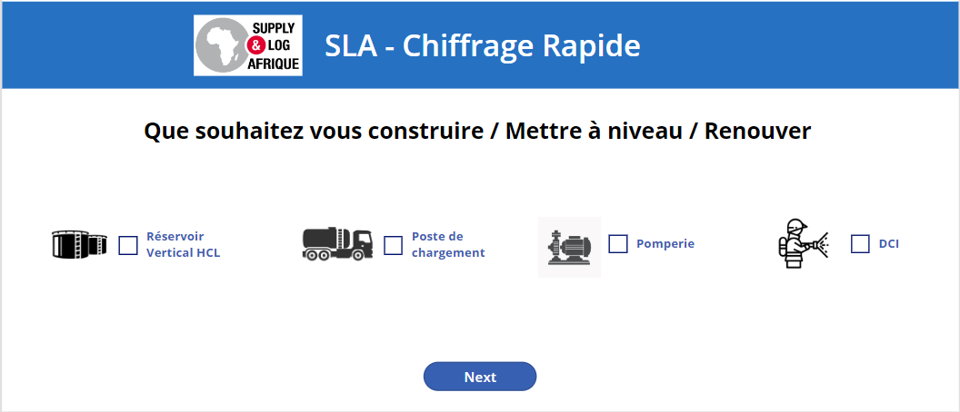

      I want to navigate between screen in my application power app, the first screen is this :

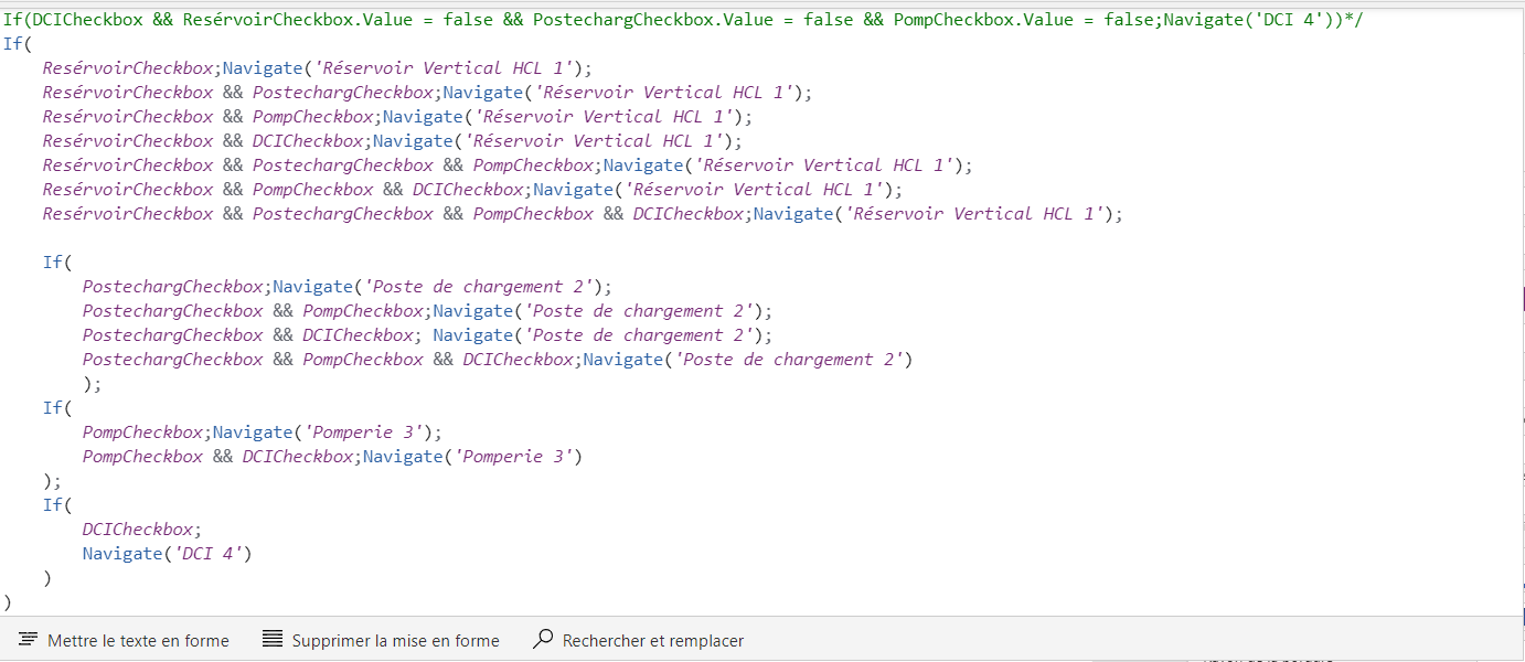

      And based on the checkbox selected, i want to navigate to it. And also navigate between the for screens if more than checkbox is selcted. For example, if i check the first and the last one, i want to go to the screen of the first one, then the screen of the last one. I want to do all the possibility, i tried this code but it’s not workingĀ
      Can someone help with this please, thank you in advance !

      Hello Enrique,Ā
      I tried to work with collections, but without success.
      in the next button, i put this code :
      Collect(ColNav;{NumeroEcran: CountRows(ColNav)+1;Ecran:’DCI 4′});;
      Set(VNavig;{Actuel:1;Total:CountRows(ColNav)});;Ā
      Navigate(LookUp(ColNav;NumeroEcran=VNavig.Actuel;Ecran))
      In every checkbox oncheck i puted :Ā
      Collect(ColNav;{NumeroEcran:CountRows(ColNav)+1;Ecran:’ScreenName’})
      on the Unoncheck :Ā
      RemoveIf(ColNav;Ecran=’ScreenName’)
      and then in evrey screen i creat a button with this code to navigate :
      Set(VNavig;{Actuel:VNavig.Actuel+1;Total:CountRows(ColNav)});;If(VNavig.Actuel>VNavig.Total;Navigate(‘Acceuil_1 apres creation prjt’));;
      But it’s not working proprely, can you tell me more about your way of doing this, thank you in advance !
