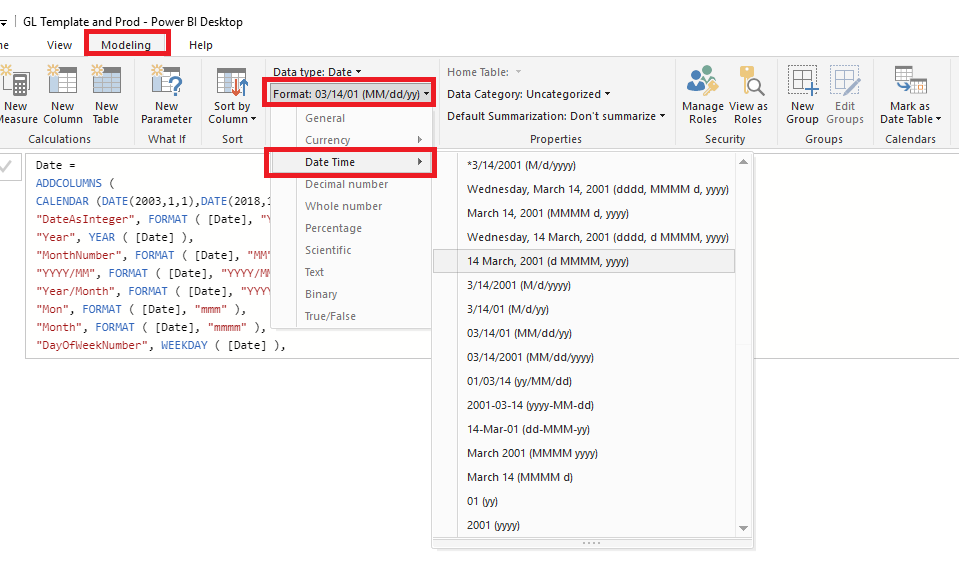

      If you’re in desktop, click on the item you want to reformat.Ā  I’ll use date in this example.Ā  You should see a yellow/orange bar on it.
      Go to the modeling tab, click Format and click date.Ā  This should give you a list of options.
      If this is still a problem, you will have to dive into your query editor and mess around with reformatting the dates.Ā  If this continues to be a problem, I’d suggest just remaking your own calendar in Navision.Ā Ā
