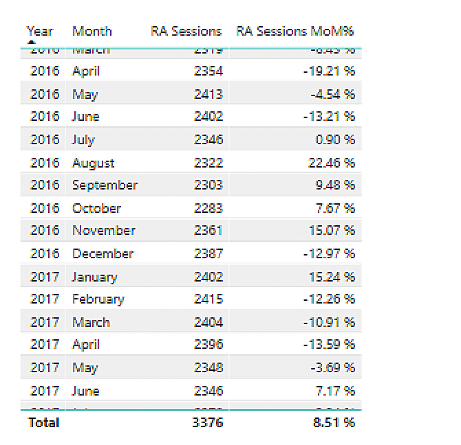

      I am trying to show the monthly percentage difference in a 12-month rolling average. I created the rolling average using a quick measure and tried creating another quick measure for month-over-month % change, but it is not calculating correctly.Ā
      Does anyone have an idea of what is happening?Ā

      ?Can you share the calculations that you are using?Ā  It is hard to make an assessment without any indications of what you did.

      Did you try creating a measure for Last Month 12 Month rolling average and then using it in the % change?
      I usually create a current total, a last month total and then do my % change by something like : DIVIDE([ThisMonth]-[LastMonth]),[LastMonth]

      Sorry – below are the calculations from the “Quick Measures”
      RA Sessions =
      IF(
      ISFILTERED(‘Date'[Date]),
      ERROR(“Time intelligence quick measures can only be grouped or filtered by the Power BI-provided date hierarchy or primary date column.”),
      VAR __LAST_DATE = ENDOFMONTH(‘Date'[Date].[Date])
      VAR __DATE_PERIOD =
      DATESBETWEEN(
      ‘Date'[Date].[Date],
      STARTOFMONTH(DATEADD(__LAST_DATE, -11, MONTH)),
      __LAST_DATE
      RETURN
      AVERAGEX(
      CALCULATETABLE(
      SUMMARIZE(
      VALUES(‘Date’),
      ‘Date'[Date].[Year],
      ‘Date'[Date].[QuarterNo],
      ‘Date'[Date].[Quarter],
      ‘Date'[Date].[MonthNo],
      ‘Date'[Date].[Month]
      __DATE_PERIOD
      CALCULATE(SUM(‘Overview'[Sessions]), ALL(‘Date'[Date].[Day]))
      RA Sessions MoM% =
      IF(
      VAR __PREV_MONTH = CALCULATE([RA Sessions], DATEADD(‘Date'[Date].[Date], -1, MONTH))
      RETURN
      DIVIDE([RA Sessions] – __PREV_MONTH, __PREV_MONTH)
      As you can see the MoM change is not calculating correctly.
