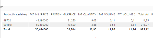

    • JĆørgen Wulff Rasmussen
      January 26, 2018 at 4:20 AM
      ?Hi Hasham
      Please see the attached picture.
      As you can see FAT Quantity and Total Volume sums correct. But FAT_Volume does not sum on totals but calculates as 11.96*925.12/1000. That formula is correct when you calculate each productmaterialkey, but when it calculates totals I expected to have the sum of the individual FAT_Volume figures. In this caseĀ the sum isĀ 3.65
      regards
      Total Vol and FAT_Quantity sums correctly but FAT Volume is a calculation sums wrong

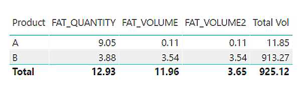

      Apologies that my expression hasn’t worked for you. I see there was a typo, a semi-colon “FactSales ; [TotalVol]/1000″Ā  which is incorrect.Ā  Also, I wasn’t aware that in Danish you use a semi-colon in place of a comma.Ā
      Here are the measures I used in the screen shot (where my table is called “Products”):-
      Incorrect – FAT_VOLUME = SUMX (Products, Products[FAT_QUANTITY]) * SUMX (Products, Products[Total Vol] / 1000)
      Correct – FAT_VOLUME2 = SUMX (Products, Products[FAT_QUANTITY] * Products[Total Vol] /1 000)
      However, this should be the correct FAT_VOLUME measure (English version) =
      SUMX (
      FILTER (
      DIMCALCDBALL, DimCalcDBAll [MatType]=”OFAT”
      ||DimCalcDBAll [MatType]=”FAT”),
      DimCalcDBAll [Quantity] * FactSales [Total Vol] /1 000)
      I’ve also coloured the brackets so you can see where they match (there was an extra one)
      The reason your measure didn’t work is that it is the equivalent of :-
      FAT_VOLUME3 = SUM (Products [FAT_QUANTITY]) * SUM (Products [Total Vol])/1000
      Whereas SUMX iterates all the rows of the table, performs the expression (“Products[FAT_QUANTITY] * Products[Total Vol] /1 000“) for every row and then sums the result for the value in the current filter context (e.g. Product A or Product B).Ā  When it hits the Total row, there is no filter context so the measure just sums the result of this expression for the entire table i.e. all rows.
      Hope this helps
      Alison
