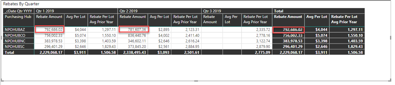

      I am using a measure in a matrix and the Row total is not correct, the total is the Q1 amount only (see below).Ā  I would expect it to be the sum of the Q1 and Q2 amounts.
      matrix
      Measure for Rebate Amount
      _mRebate Amount =
      CALCULATE(SUM(‘Rebate Invoices'[Rebate Amount]),
      FILTER(‘Rebate Invoices’,
      ‘Rebate Invoices'[_cClose Date Qtr YYYY] = ‘_Date Time Slicer'[_mDate Qtr YYYY Selected]))
      Any suggestions/ideas would be greatly appreciated.

    • Hasham Niaz
      August 27, 2019 at 9:35 PM
      Hi !
      Can you give it a try;
      _mRebate Amount =
      CALCULATE(SUM('Rebate Invoices'[Rebate Amount]),
      FILTER('Rebate Invoices',
      'Rebate Invoices'[_cClose Date Qtr YYYY] <= '_Date Time Slicer'[_mDate Qtr YYYY Selected]))
