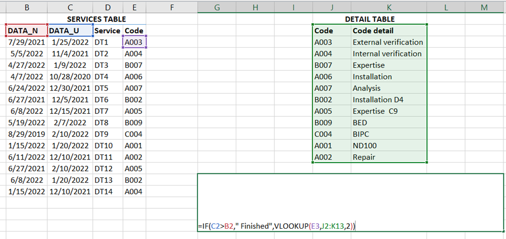

      Hello guys
      Please help me with a DAX solution for this case
      I have 2 tables without a relation, one called “Services table” and another “Detail table” where the code detail it is written.
      I want to add a column in “Services table” where if DATA_U is greater than DATA_N, than “Finished” , else bring the code detail from columnĀ  DETAIL TABLE.
      In excel i put the formula =IF(C2>B2,” Finished”,VLOOKUP(E3,J2:K13,2))
      I know that i can merge queries based on the code column and bring the detail intro one table but i need a DAX formula for this.
      Thank you

      Tente
      Medida =
      IF (
          [DATA_U] > [DATA_N],
          "Finished",
          LOOKUPVALUE ( Tabela2[Code Detail], Tabela2[Code], Tabela1[Code] )

      Hi Mihai,
      “I have 2 tables without a relation”
      Why? Your Detail table is PURE DIM table. Make relation on it.
      Do it like a Pro should do šŸ™‚
      @Vilmar Gave you one of solution, so no need more.
