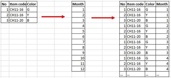

      Hi all,
      I have 2 tables, one is Product & one is Month (12 months), how can I join 2 tables together? I mean add every month from table Month to table Product like picture bellow?
      thumbnail image
      Thanks for your help!
    • Audrey Abbey
      February 12, 2018 at 11:50 PM
      Hi Tung,
      These tables do not share a column.Ā
      The results you show is called a Cartesian Product.Ā
      In the code, we use a cross join to do that.Ā
      DAX:
      https://msdn.microsoft.com/en-us/library/gg492168.aspx
      You can also add a Custom Column via Query Editor and add the query for one table as a column for the other.Ā
      Or add a custom column to each table, and populate with the value 1. Then merge the tables on that column.Ā
      I am sure there are a few other ways to achieve it…but that should get you started.Ā

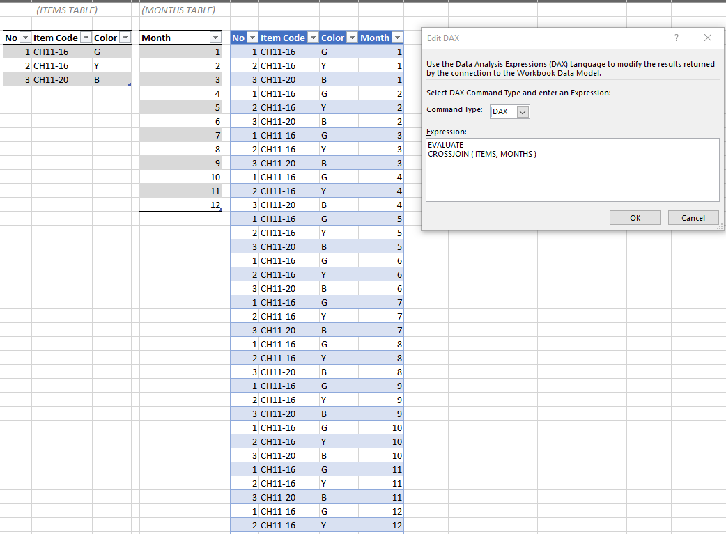

    • William Rodriguez
      February 13, 2018 at 10:17 AM
      Greetings @TungĀ Pham :
      is correct. Below illustratesĀ her ?recommendation
      CrossJoin
      William
      #DAX?
