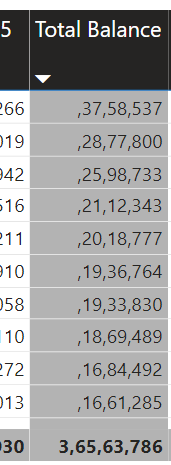

      I tried using the code you sent, and I am getting an extra comma, in front of values that are less than 10 million.
      After the last 3 digits ROUNDED OFF to 0, I would like the thousand separator after every 2 digits, i.e. 00,00,00,00,00,000

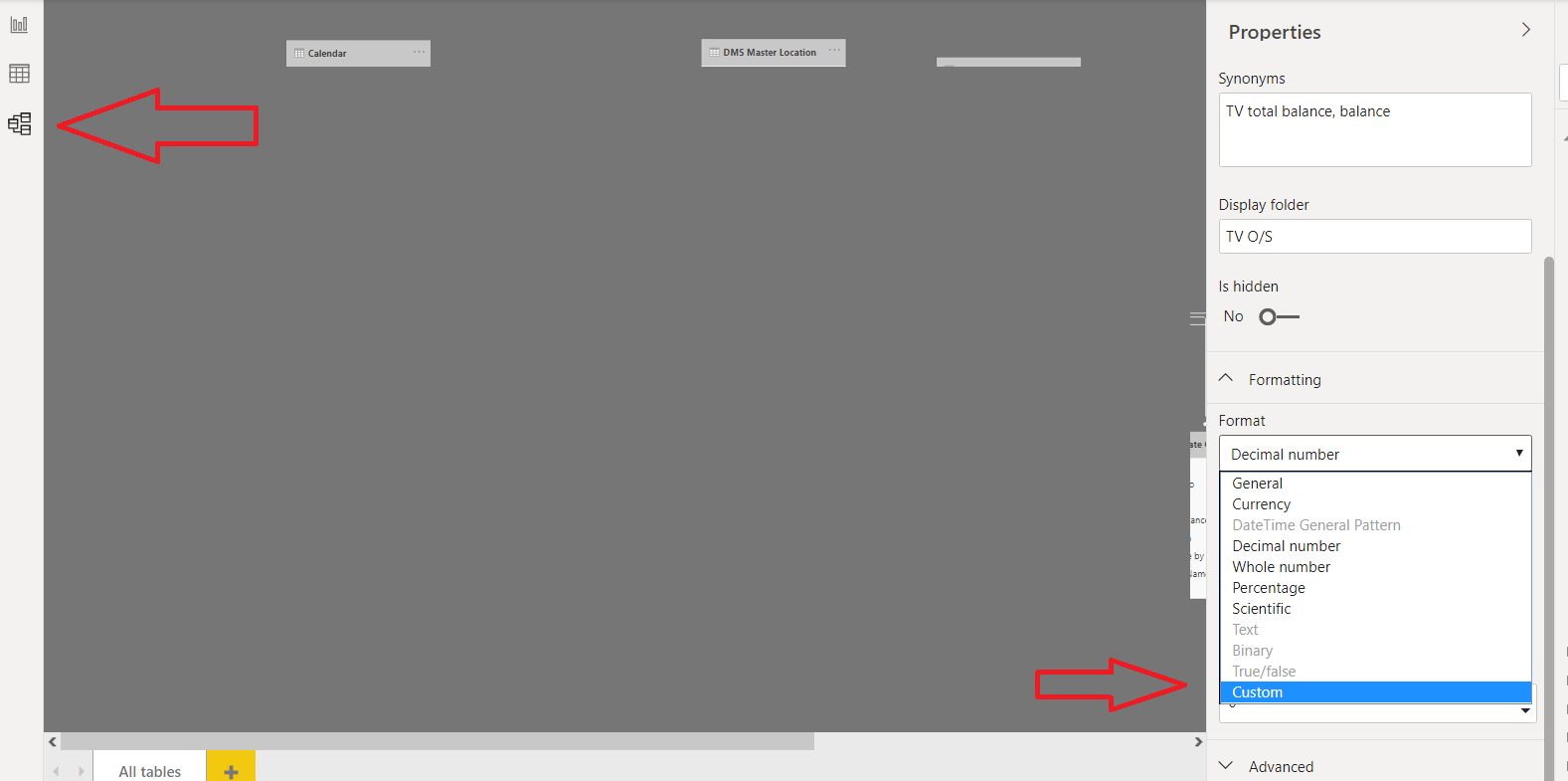

    • Vishesh Jain
      June 23, 2020 at 5:12 AM
      Hello ,
      I am trying to change the format of the number from the relationship view. I hope the picture will clear out any confusion.
      I do NOT want to change the format of the number to text, I just want to change the display format of the number.
      I want the commas between numbers to be like thisĀ 00,00,00,00,00,000 and I do not want a comma precedingĀ the number if the number is small.
      I hope this clears out any confusion.

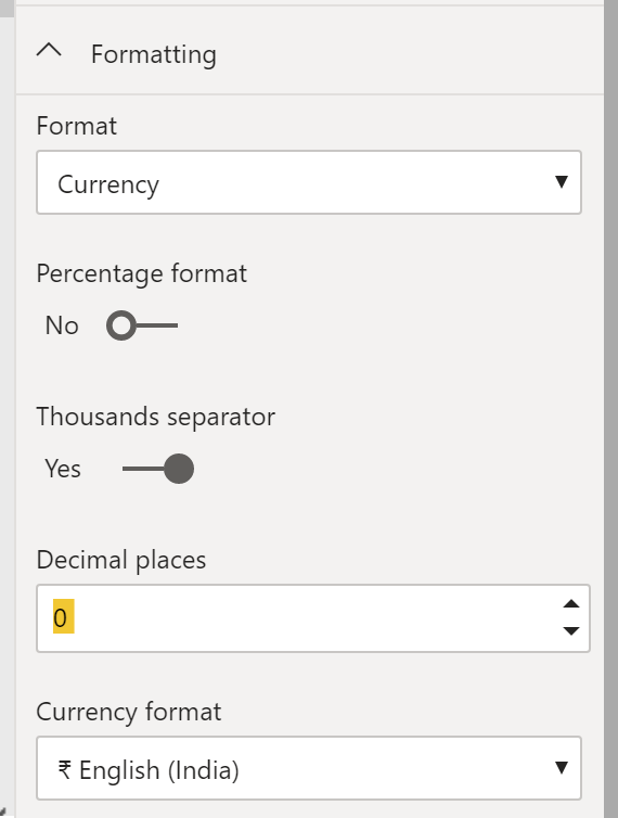

    • Gopa Kumar Sivadasan
      June 24, 2020 at 3:52 AM
      Is your issue resolved? If not, please see if the following helps you.
      Is your issue from the Power BI service or Power BI Desktop? Is it that despite selecting the currency display format of the measure as ‘English-India’ in the pbix, the display in Power BI service reverts to millions while in desktop it displays properly?

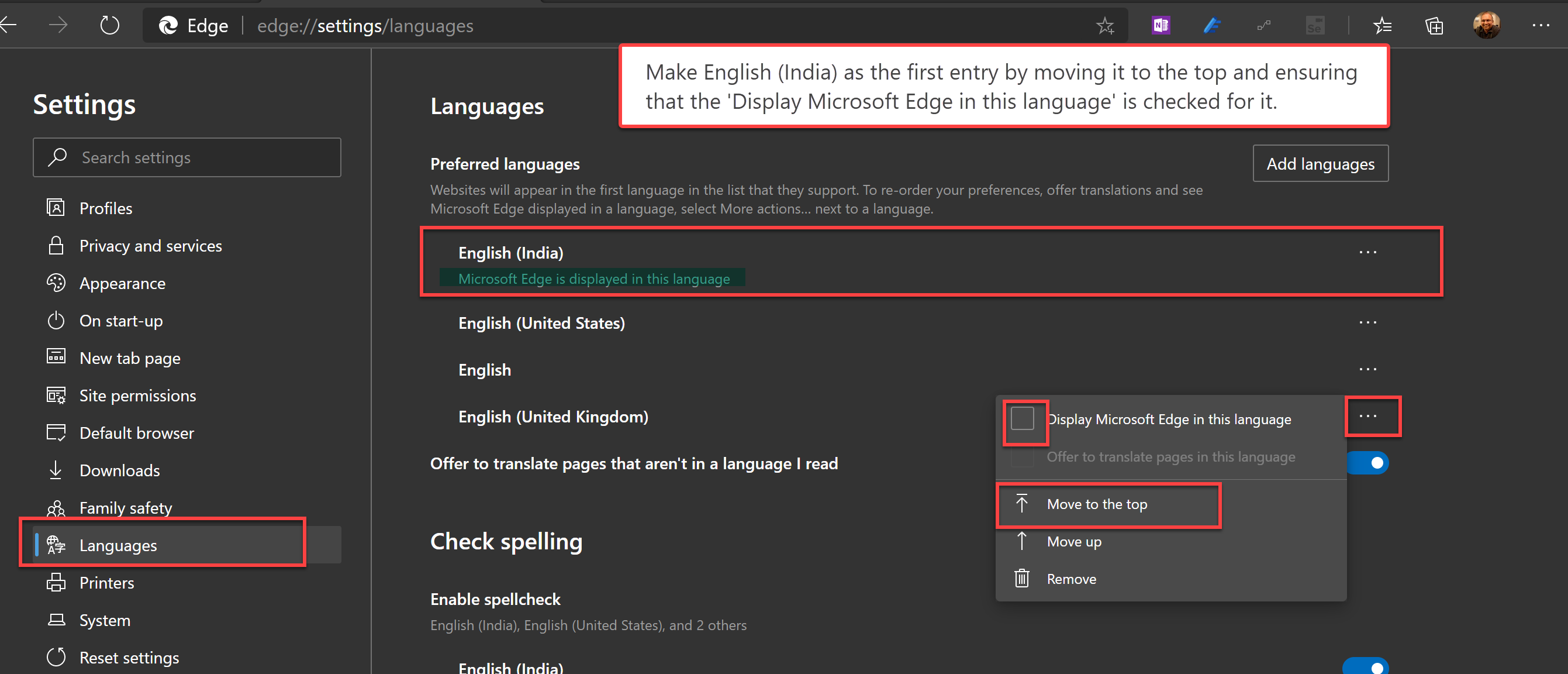

      If the issue is with the Power BI service, despite having the proper currency display format in desktop, the issue could be the language setting of your browser, through which you are accessing Power BI Service. To change the language setting of the browser, please see the below images:
      1. Edge Browser
      1. Chrome Browser

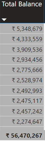

    • Vishesh Jain
      June 25, 2020 at 5:14 AM
      Hi ,
      ??I have made the changes as you asked for it and it has worked in the PBI Desktop.
      However, even after making the changes in the desktop and the browser the numbers are still showing up at millions on the service and on the PBI app as well.

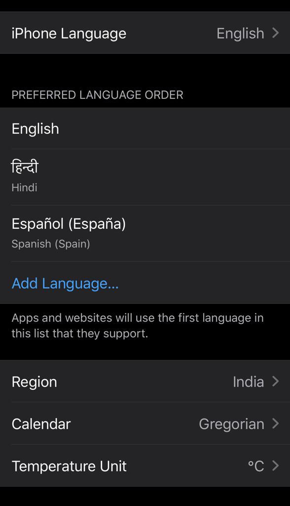

    • Vishesh Jain
      June 26, 2020 at 2:21 AM
      HiĀ ??,
      That worked perfectly for the browser, but it is still not working for the mobile app.
      I have changed the default language in the phone and changed the region to India.
      I even downloaded the app from the Indian app store and it is still showing the numbers in million format.
