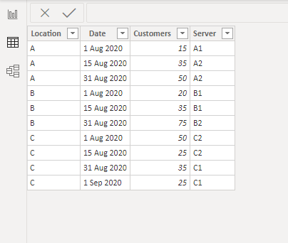

      I have a data table which has details about which server has served how many customers on a particular day at which location, which looks like this:

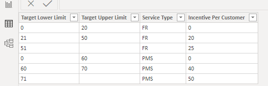

      Then I have the incentive table which has the lower and upper limits for the total number of customers served and the incentive per customer, which looks like this: (format of the incentive table can be changed)
      FR is for Free service type and PMS is for Paid services. When the upper limit is blank, it means anything greater than the lower limit.

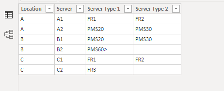

      The DIM table has the details which server serves which type of customers and looks like this.
      The incentive of a free server FR1/2/3 should come from the service type ‘FR’ from the incentive table and those with PMS20/30/60> should come from the PMS server type.

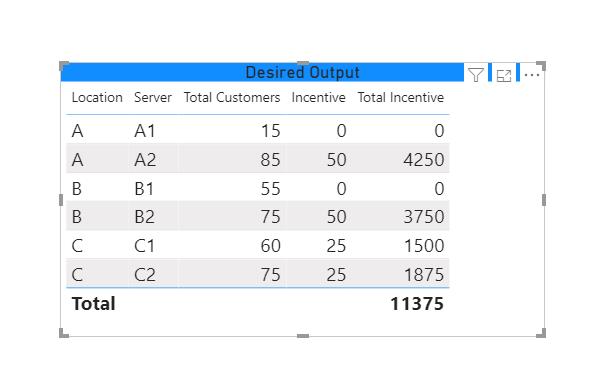

      Here is the desired output:
      I would like to have a measure to calculate the Incentive Per Customer based and another measure to multiply the total customers with incentive, which works at the location level as well.
      For e.g. For Location A total incentive should be (15*0) + (85*50) = 4250 and NOT (100*50) = 5000

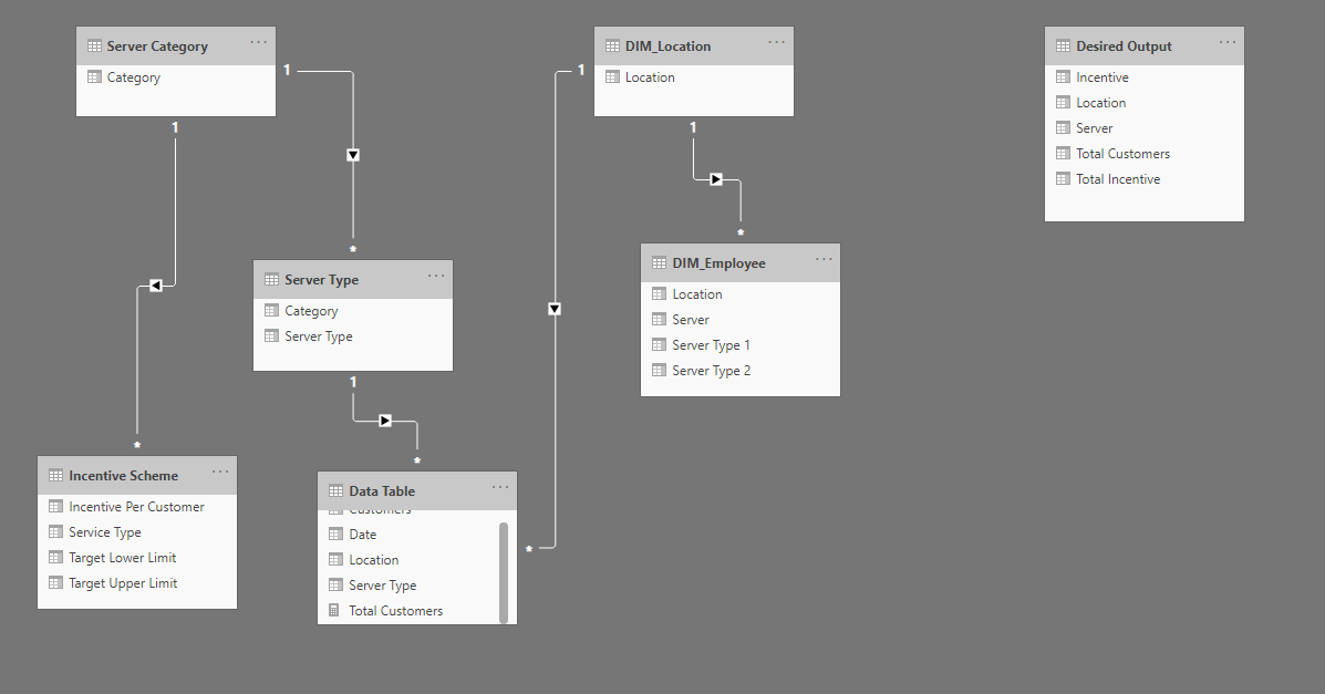

      I have changed the data model a bit and it looks like this now.
      I am attaching my sample file as well, which has the data table without the server name and just the server type.

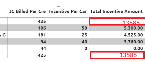

      Here is a screenshot of the progress of the real report:
      The only thing I am missing is filling in the red boxes with the total of 5300 + 4525 + 3760 = 13585
      I have already tried SUMX() and it was not working.
      Hope someone can help me out.

    • Vishesh Jain
      September 10, 2020 at 5:51 AM
      Hello everyone,
      I think I have got the solution, thanks to from SQLBI.??
      I referred to this video, which showed using VALUES() function inside of SUMX() to sum all the visible values and it worked.
      https://youtu.be/YtIdcCYnZ9w
      I hope if ever someone else has this problem, they can refer to this thread and the video as well.
