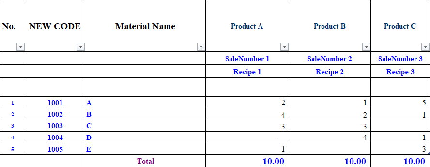

      I have a date structure as below:
      Each Product has a SaleNumber and a RecipeNumber. It includes multiple ingredients: A, B, C, D, E (each ingredient has a code)
      I want to use Power Query to unpivol, transform to my structure better and logic more (sorry for my EN skill).
      May you help me!
      Thank you!

      Could you clarify what output you want ?Ā  And will the source file always have the same number of columns ?

      Hi Hai,
      SaleNumber1, 2 and 3 you should have in measure at least from different source.
      Recipe 1, 2, 3 you should kick to DIM table and make relation.
      Than on column ‘NEW CODE’ just remove empty.
