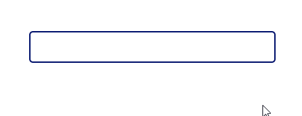

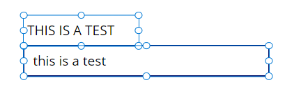

      This isn’t a perfect or elegant solution [EDIT – see Warren’s below], but it works –Ā
      Insert a Label (Label11 in screenshots) and Text Input field (TextInput1). Arrange them so that the X,Y values are the same in the canvas and in the Tree view on the left, make sure the Text Input field is above the Label so that it will receive the focus from the tab or mouse selection.
      Set the following properties:
      • TextInput1
        • Color – transparent (use the picker or just set the A value of RGBA to 0)
        • Fill Color – transparent
        • Hover Color – transparent
        • Hover Fill – transparent
        • Maybe Pressed and Focus colors as well?
      • Label11
        • Text = Upper(TextInput1.Text)
        • X = TextInput1.X
        • Y = TextInput1.Y
        • Width = TextInput1.Width
      Test in play mode
      Edit mode, after test, with fields un-stacked and TextInput1 Color set back to Black.
      Downside – you can’t see the cursor in the TextInput field since it is transparent, but if you select and just start typing it works.
      Hopefully this helps or sparks other ideas.
