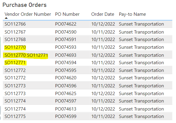

      I thought it might be helpful to provide a little context before asking my question. Retailers order items my company makes and we ship it to them. Then the shipping company sends us an invoice. We create a Purchase Order (PO) for that invoice and tie it to the Sales Order (SO) the customer sent in so we can keep track of shipping costs by customer. Very often, we get multiple multiple Purchase Orders for the same Sales Order and we need to delete one out of the system.

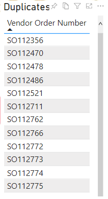

      Now my question! I have a simple report that calls out the duplicates so we can easily find and delete them. I’ve attached screen shots below of the Purchase Order list and the list where it calls out the duplicates. As you can see it works well except for SO112770 and SO112771 which are both duplicates but not picked up on the duplicate list because they were combined on one PO. The order number has to be EXACTLY the same to catch the duplicate which does not always happen. Is there a way in Power BI to catch these duplicates too?

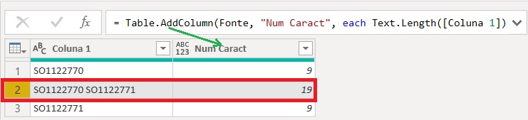

      Se não hÔ critérios para remover os duplicados, uma alternativa no Power Query seria:
      1. Adicionar uma coluna contando a quantidade de caracteres;
      2. Em seguida fazer um filtro para manter apenas aquelas linhas que contĆŖm 9 caracteres

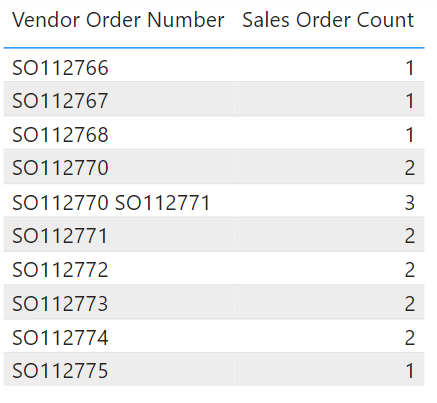

      Let’s try to solve it with DAX first. With CONTAINSSTRING we can search for sales orders as substrings of other sales orders:
      Sales Order Count =
      VAR CurrentSO =
          SELECTEDVALUE ( Table[Vendor Order Number] )
      VAR AllSO =
          ALL ( Table )
      VAR FilteredSO =
          FILTER (
              AllSO,
              CONTAINSSTRING ( CurrentSO, Table[Vendor Order Number] )
                  || CONTAINSSTRING ( Table[Vendor Order Number], CurrentSO )
      VAR Result =
          IF ( ISINSCOPE ( Table[Vendor Order Number] ), COUNTROWS ( FilteredSO ) )
      RETURN
          Result?
      This gives the following result:
      There is one serious limitation with this solution. If a SO that is a part of a string of SO’s has a duplicate in another non-identical string of SO’s it will not be counted twice.
