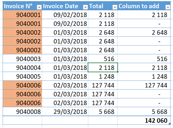

I have a table in which there are lines (invoices) that repeat themselves. I want to create a column in which I copy the amount of each invoice for the first time and put a zeros for the duplicates. below is an example.

Hi ,
The best way to remove duplicate by using Power Query
Go to Power Query —> Home –> Highlight Invoice N & Invoice date —-> click in Reduce Rows — > Remove Duplicate.
Thanks, Feras?
