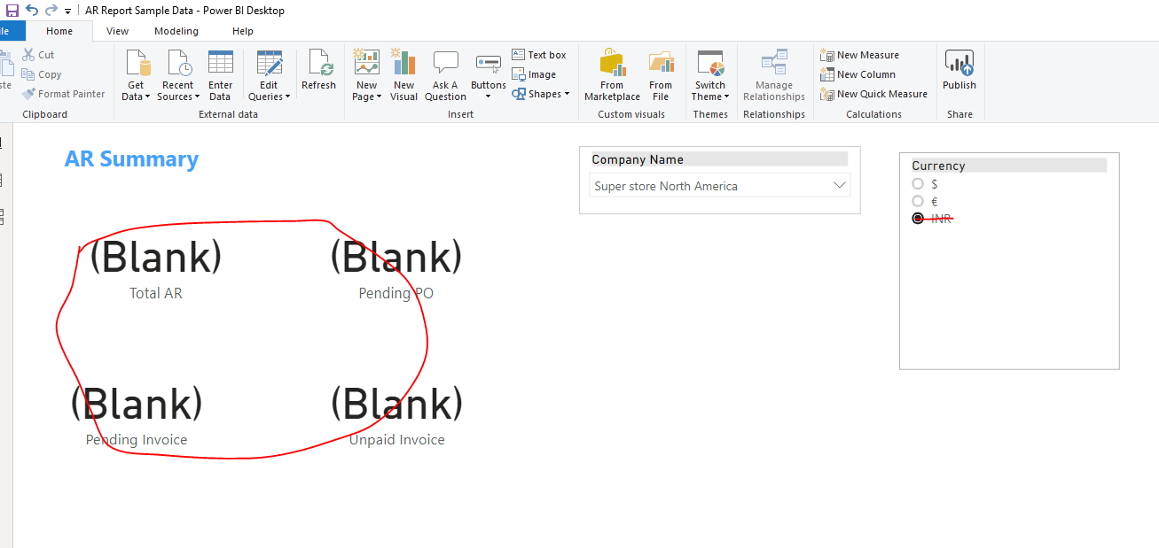

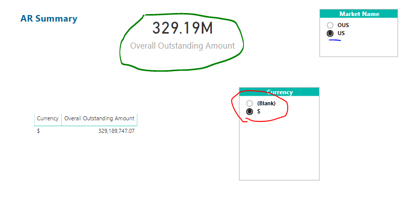

      I need dynamic single select slicer for my report.
      Currently, I’m using normal slicer with single select. when i am filtering OUS – Market it has except $Ā currency. that case filter dynamically not changing to other currencies.Ā (Note: i don’t need multi select because that one gives wrong metrics to my card visual)
      Can you please suggest me the best slicer for my case.
      Thanks in advance!

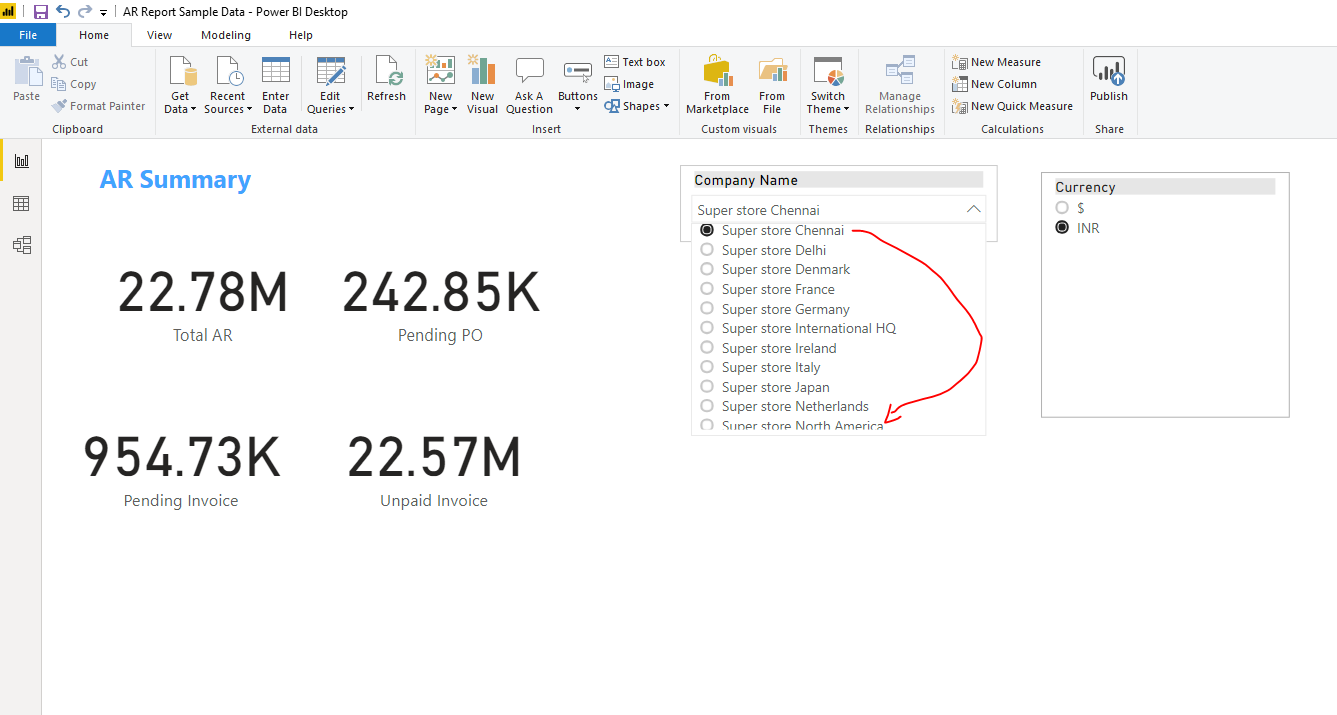

      I have added the Pbix file with sample data in Google drive: https://drive.google.com/open?id=1yoTzTFX0zWR4fmTAG3glOiuhkH2qYqgU
      Ā currently i selected company – chennai & currency – INR. If I’m changingĀ company to North America. Currency is not dynamically changing to ($ or €). it’s dynamically needs to be changed.
      Can you please advice me

    • Mohamed Ibrahim
      November 6, 2019 at 6:52 AM
      Thats because you have enabled single selection. Please turn that off to get the update. I am attaching the updated file

    • Gopa Kumar Sivadasan
      November 11, 2019 at 10:54 AM
      I apologize. I do not think the setup I mentioned above will work in your case. Alternatively, what you can do is convert the currency slicer to a single column table visual. This will filter the currency according to the shop you select. Further, you can still slice the amounts by currency by selecting the relevant row in the table.
      PFA the pbix file.?

    • Ramar Veerasamy
      November 12, 2019 at 2:34 AM
      Hello ?, Thanks a lot.
      Best Option: I don’t have converted currency value in our DB. if i am adding measure for converting the all currency to $. then the report page & query loading taking time. Our user’s won’t accepts.
      Requirement: when applying the company filter then currency filter needs to automatically select the non blank currency
