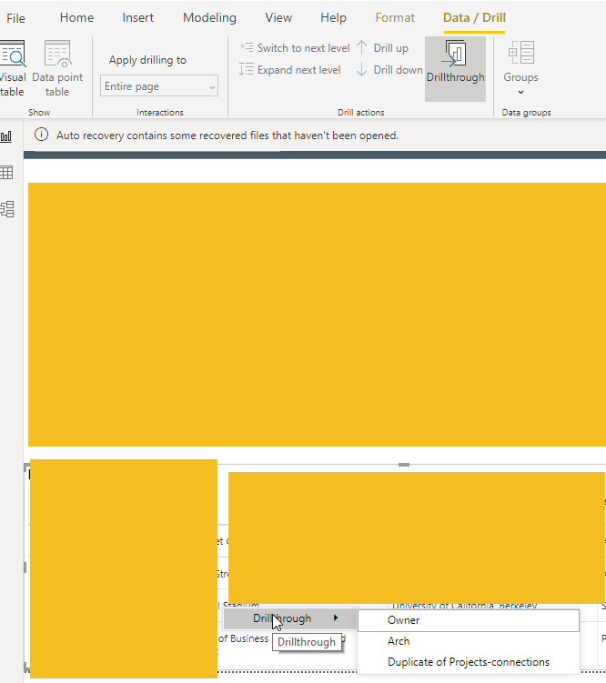

      I know the drillthrough feature is frustrating for many of us, the right click feature many times doesn’t fit the stakeholders requirements.
      However, I have noticed that there is a drillthrough feature on the top editing bar, when this is turned on, a user can left click and the drillthrough options will appear (see photo below)
      The issue I am having here is when I upload this report online, this drillthrough feature turns off. I have tried turning this feature back on once the report is published, but it seems to automatically turn off every time the page is refreshed.
      Does anyone have a solution to this? Or does anyone know another solution to drillthrough that does not include right-clicking? Thanks

      Hi ,
      check out this link, if you haven’t already:Ā https://docs.microsoft.com/en-us/power-bi/desktop-cross-report-drill-through
      It describes setting it up both in Desktop and the web service, and what to keep in mind. Maybe it’s referring to a report in another workspace?

      You can leverage URL parameters and create a drill through hyperlink instead of the drill through context menu. I just stumbled across this guy in a cube video where he shows a (new?) feature that lets you turn any column into a hyperlink. So you could leverage existing columns in your table or create a new one that is “click here for Owner” or “click here for Arch” etc…

      This looks great, do you know how I could leverage url parameters and allow them to let me click the link and take me to a new page in the report.

      How would a bookmark eliminate the right click drillthrough? I am looking to have the stakeholder be able to click on a field in a table and have them taken to the new report page.

      Set the bookmark to be the URL of the page you want to go to.

      I have tried what you sent me and when I click on the url, it opens up a new web tab with the report view. Is this the intended result? Is there a way to just modify the report view in the same web page?

      Yes, at least in that has been my experience as well. I use it mostly as a jump from PBI to paginated, so I haven’t had anyone complain about the new tab. I’ll poke around and see if I can find anything about changing the new tab behavior. But it might just be a handicap we are stuck with for now. Not the best user experience but not the worst either. The benefit of a new tab is they don’t need a way to “go back”, they just close the “drill through” and they are back on the main page and can view the next section.
