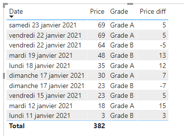

      I built a table called ‘Prices’ as following :

    • Martin Pogacnik
      January 23, 2021 at 11:26 AM
      Hi Nicolas,
      thank you so much for taking the time!Ā  I am a total novice here, so really appreciate it.Ā  The result is as it should be, except my description was incomplete:Ā  how would the formula change, if Price diff were always calculated only in one direction, i.e. Grade A – Grade B, such that, for instance, the result in the third row (22-Jan, 64, Grade B) would show 5 rather than -5 as Price Diff?

    • Martin Pogacnik
      January 23, 2021 at 3:41 PM
      Hi Kay Li,
      thank you for this.Ā  Actually, I was not looking for absolute difference, but one-directional difference only, and with an added complication that there are more than two grades.
      The approach suggested by Nicolas, modified slightly with an additional IF statement, worked here as well.
