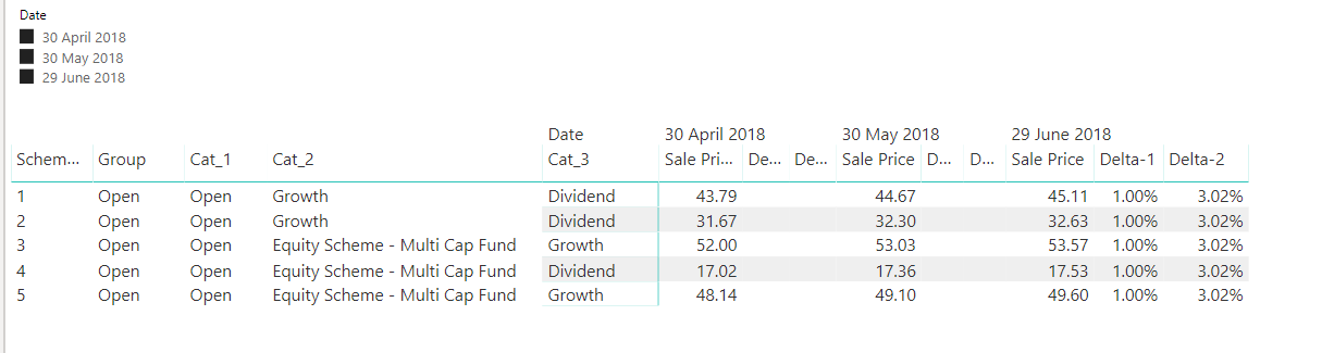

    • Gopa Kumar Sivadasan
      August 26, 2019 at 4:20 PM
      I suppose you have got the solution from
      Below is another take on it. The below solution assumes the following:
      1. You may have multiple dates coming in future;
      2. You may have to dynamically select dates to compare;
      3. The maximum date you select in the slicer is the base date against which the deltas are calculated;
      The only downside to the solution is that extra space is created between the comparing periods by the additional blank columns. Since now, we cannot have conditional column headers, I am not sure whether we can do anything about it. If the additional blank space is not an issue, please see if the following helps you:
      The DAX for Delta for the base date -1 period is below:
      Delta Latest Selected Month -1 =
      //dates calculations
      VAR _maxslicerDate =
          CALCULATE ( MAX ( InputTable[Date] ), ALLSELECTED ( InputTable[Date] ) ) --maximum of the slicer selected date. This is the base date
      VAR _rlvntDate =
          SELECTEDVALUE ( InputTable[Date] ) --date in the current context
      VAR __selectedSlicerDates =
          CALCULATETABLE ( VALUES ( InputTable[Date] ), ALLSELECTED ( InputTable[Date] ) ) --all the dates selected in the slicer, ignoring date filters coming in from the visual itself
      //since we are looking back at the immediately preceding period from the base date, we select the top2 dates
      VAR __top2Dates =
          TOPN ( 2, __selectedSlicerDates, InputTable[Date], DESC )
      VAR _maxdateminus1 =
          CALCULATE ( MIN ( InputTable[Date] ), __top2Dates ) --the minimum date from the above top2 table will be the immediately preceding date
      //delta calcualtion
      VAR _baseSalePrice =
          SELECTEDVALUE ( InputTable[Sale Price] ) --get the saleprice for the base date
      VAR _rlvntSalePrice =
          CALCULATE (
              MAX( InputTable[Sale Price] ),
              ALLSELECTED ( InputTable[Date] ),
              InputTable[Date] = _maxdateminus1
          ) --get the saleprice of the immediately preceding date
      VAR _deltaminus1 =
          DIVIDE ( _baseSalePrice - _rlvntSalePrice, _rlvntSalePrice ) -- calculate the delta
      RETURN
          //we show the values only for the base date, other columns return blank
          IF (
              _rlvntDate = _maxslicerDate,
              _deltaminus1,
              BLANK ()
      You can create additional deltas by changing the TOPN value accordingly as has been done for the delta –2 measure.
      PFA the pbix file for your reference.
