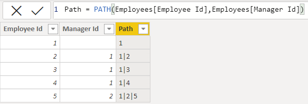

      I know that the PATH-function expects 2 columns (an Id and a Parent Id) and it returns the path from the top to the bottom, separated by the |-sign, as shown in the following screenshot
      If the manager changes, we can simply update the data and it will still work.

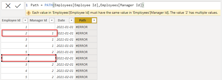

      But what if you have a ‘daily’ or ‘monthly’ view of your data. In that case, the formula returns an error
      (In the following example, Person 1 left the company in February and person 2 become the top-manager
      So I want that the PATH-function searches for the path, but taken into account the date.Ā  And I can’t manage to do this.

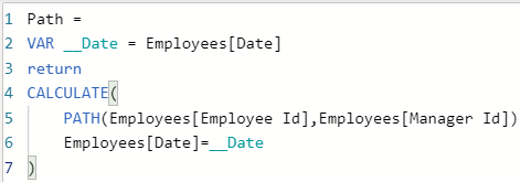

      It’s like the Path-function doesn’ use my filter. This is my formula:
      Maybe it’s because DAX rescans the table for every level and that my filter is only working on the first level? But I don’t see how I would have to use then the earlier or earliest function. Or maybe another function?
      Any one has an idea?

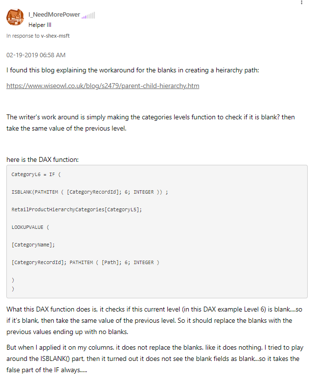

      This blog explains the workaround for the blanks in creating a hierarchy path:
      https://www.wiseowl.co.uk/blog/s2479/parent-child-hierarchy.htm
      Hope this helps you, to tactically remove the null entry from the PATH.

      Hi Sowmya,
      First of all, thank you for taking the time to respond.
      But the links that you post have nothing to do with this problem I think.
      The blanks are not the problem.Ā  The problem is that I cannot find the path to the parent as a user can have multiple parents.
      But they have only 1 parent on a specific day.Ā  So I’d like to find the path taken into account the date.Ā  And it’s very easy to filter a table, but the PATH-function requires a column, not a table.Ā Ā
      Or did I overlook something?
      Johan
