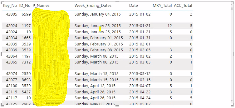

      I have table like this
      Now I want to show current Current week, Last one week, Last two weeks, Last three weeks ,Last four Weeks “ACC_Total”.Ā How to write dax for this I’m taking date from Date column

      Hi Phaneendra ,
      I think the best way is to create a calendar table first, where you can define specific columns like current week, last week, … based on current date.
      Linked to the date of your table you’re be able to apply dax measure filtering on calendar columns.

    • Phaneendra Adusumilli
      June 30, 2022 at 3:32 AM
      Already I have calendar column is there no

    • Hugh Johnson
      June 30, 2022 at 9:08 AM
      Hi Phaneendra, the way that I would tackle that problem is to drive this from your ‘Dates’ table with a Dates[RelativeWeek] column where 0 is this week, -1 is last week, 1 is next week and so on.Ā  It is then very simple to add Dates[RelativeWeek] as a filter condition in a CALCULATE function.

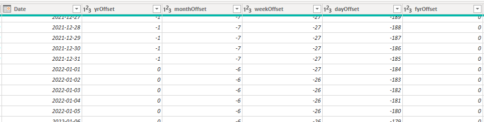

    • Bob Parsons
      July 4, 2022 at 3:52 PM
      Agree with …
      Setup up your calendar with ‘Offset’ columns. I always include Days offset, Weeks Offset, Months Offset, and Years Offset.? Makes it easy then to specify exactly what time-period you want to calculate in the measure.Ā
      here are a few DAX examples:
      – Sales total for 2 years ago,Ā
      Sales -2Yr = CALCULATE (SUM ( 'Sales'[Sales] ),'Date'[yrOffset] = -2)
      – Same Month, 2 years agoĀ
      Sales Same Month -2yrs = CALCULATE (SUM ( 'Sales'[Sales] ),'Date'[monthOffset] = -24)
      – Sales 17 weeks ago
      Sales 17 weeks ago = CALCULATE (SUM ( 'Sales'[Sales] ),'Date'[weekOffset] = -17)
      … etcĀ
      you get the idea – extremely flexible especially with weeks which is not included in the time intelligence calculations.
