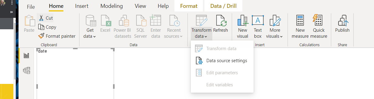

    • Gabriela Ganciu
      October 30, 2020 at 11:37 AM
      Thanks for replying!
      When going under Transform Data? this is all I get:
      Strangely, when selecting ‘Data source settings’ it’s asking me to select my data source once again and creates a new empty dashboard.

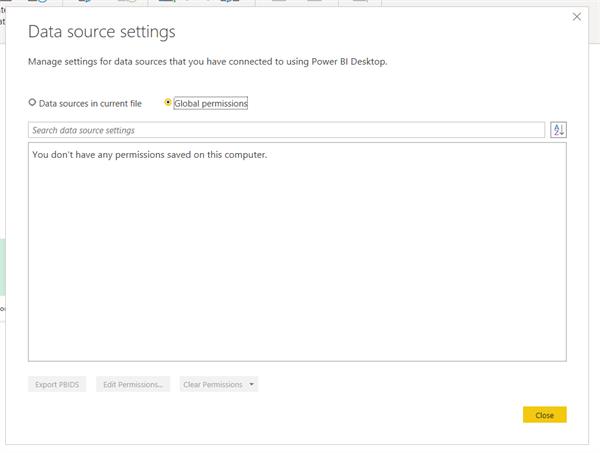

      However if I try create a new report (without selecting a data source first) and go to Transform Data > Data Source Settings, I get this:
      Could you please advise?

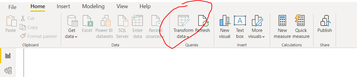

    • pouneh Samavatian
      October 30, 2020 at 12:51 PM
      don’t click on the arrow but on the picture( Transform data) then you will get into this page with your own data:
      pouneh Samavatian
    • pouneh Samavatian
      October 30, 2020 at 12:54 PM
      on this pic but not the arrow
      pouneh Samavatian
    • Gabriela Ganciu
      November 2, 2020 at 2:24 AM
      It looks like ‘Transform data’ (which seems to take you to the Query Editor) ??is not an option for me. Can it be enabled by any chance? Or do you know why it would be grayed out?
