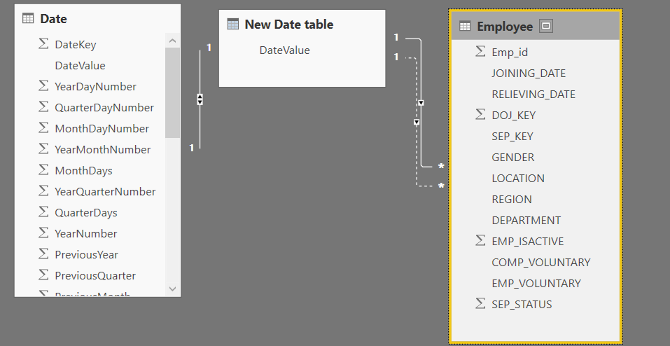

    • Vishesh Jain
      January 30, 2019 at 3:34 AM
      Hi ,
      ?To answer your first question, in order to filter the date table based on the minimum date of your DOJ, you will have to create a bridge date table, that is already filtered based on the DOJ. I would not recommend a permanent filter on the main date table as then your calculations might get affected.
      This way since your bridge table will have a single column with distinct values, it will have a bi-directional relationship with the main date table, so you can use either one as per your requirement and it will not bloat up your data model either.
      As for your second question, I think that is happening probably because your date table contains values, which go even before the min DOJ.
      So I would recommend that you put a filter in your measure where you can specify that DateValue >= Min[Employee[Joining Date].
      This way all your calculations should take into consideration the Minimum DOJ.
      I am afraid this might be as far as I can help you out, unless you upload your sample PBIX file.
      I have attached my PBIX for the bridge table solution, so please check it out and I hope this resolves your problems.
