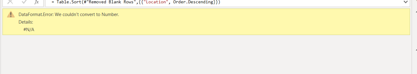

      The only thing I get with “Keep Errors” is a yellow message: “DataFormat Error”

      It’s telling you the value of the field is “#N/A”.Ā  You’ve said you are removing “N/A” values in your query.Ā  Are you also removing “#N/A”?

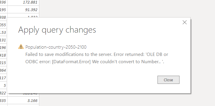

      I cannot do that because when I click on Apply I get the error:Ā Ā [DataFormat.Error] We couldn’t convert to Number

      The full error message is:
      Failed to save modifications to the server. Error returned: ‘OLE DB or ODBC error: [DataFormat.Error] We couldn’t convert to Number.. OLE DB or ODBC error: Exception from HRESULT: 0x80040E4E. OLE DB or ODBC error: Exception from HRESULT: 0x80040E4E. ‘.

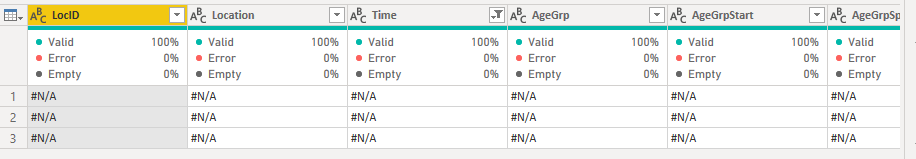

      So I was able to isolate the error to your ‘2050-2100’ file and it contained #N/A values as suggested by .
      After trying to remove the #N/A from within power query, I was unable to do it, IDK why.
      So eventually I had to resort to modifying your data files and removing the errors there. Even there, for reasons unknown when I tried to filter out the #N/A the last row somehow got hidden. So I manually modified the file and Voila!!!

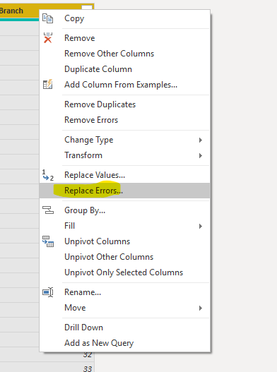

      Have you tried in query editor ??the M function ‘Table.ReplaceErrorValues’? To access from UI right click the column header and select the ‘Replace Error’ option. If you type the value to replace as null, then in the returned table in power BI desktop you will get blank value, or you can replace with any value for that matter.
      ?Please see if this helps you.

      The issue, as was mentioned by others, was in the Population-country-2050-2100.csv. As shown below the error shows in 3 rows in all the columns. Since some of these columns are number types, it throws the error in power BI.

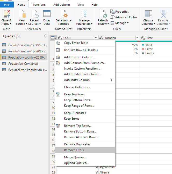

      However, you have two options to remove errors. #NA etc are errors and you should avoid replacing by the normal replace method. You should replace / remove the errors with explicit M functions for errors.
      The first option is to remove all the error rows using ‘Table.RemoveRowsWithErrors’. This will remove all the rows with errors. From UI, you access it as below:
      In the pbix I have used this.
      Second is the one I had mentioned in the thread earlier viz replace errors. In this case, the replace should happen immediately after the change type. But then, you have to do this individually in all the columns where the format error happens. In your case, the fields population-male , population-female was changed to decimal later in the step. The replace for these should happen immediately after this. I have created an additional query to show this. You can look at the steps. Also, in the desktop, you can view both the tables and see that the table using the 1st method has 3 rows less than the 2nd method table as the 3 error rows were removed in the 1st method.

      I hope I am not too late to the party. I found a solution that worked for me when I had this same problem. In your steps, you will see the “Changed Type” in power query editor. If you click on the formula bar, you should be able to edit the type to text from Int64.
