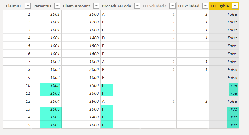

    • Gopa Kumar Sivadasan
      August 29, 2019 at 7:11 AM
      If I understand you correctly, a patient should be marked as ineligible if he has at anytime done an undesired procedure code. If my understanding is correct, please see if the following helps you (in this example Procedure Codes A,B,C,and D are undesired):
      You can use the [Is Eligible] column to filter the relevant patients in your visual.
      Basically, I have added two calculated columns using the following DAX:
      Is Eligible =
      --total the "is excluded" values for each patient, ignoring the row context filters from other columns
      VAR _totalIsExcuded =
          CALCULATE (
              SUM ( 'Claims Table'[Is Excluded] ),
              ALLEXCEPT ( 'Claims Table', 'Claims Table'[PatientID] )
      RETURN
          --the total isexcluded value will be blank only for those patients who never had an excluded procedure
          IF (
              ISBLANK ( _totalIsExcuded ),
              TRUE (),
              FALSE ()
      Is Excluded =
      --based on seperate table for ineligible procedures
      IF (
          'Claims Table'[ProcedureCode]
              IN VALUES ( 'Excluded Procedures Table'[ProcedureCode] ),
          1,
          BLANK ()
      Column [IsExcluded] is added twice just to show the different approach to store the Undesired procedure code. Either hardcoded into the DAX or keep a separate table for the undesired codes which is easy to maintain, should there be changes in the undesired codes in future. If you ask me; if you anticipate changes, then better to maintain in a separate table.
      Apologies if I have misunderstood your issue.
      PFA the pbix file for your reference.
