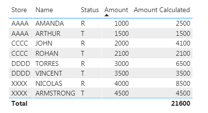

      I’m trying to create a mesure with a condition but I’m failed.
      It seems very simple at first but it is not !!

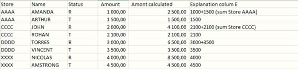

      Amount calculated is If status is R then Store AmountĀ  Else Amount
      Thanks in advance
      Boby

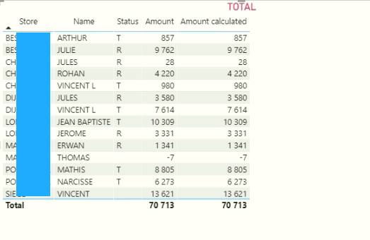

      My formula :
      amount]calculated =
      var __Store = SELECTEDVALUE(Store[StoreName])
      var __Status = SELECTEDVALUE(User[Status])
      var __Tot_R = calculate(sumx(ALLSELECTED(User), [total amount] ),Store[StoreName]= __Store)
      var __Tot_T = [total amount]
      return if (__Status =”R”, __Tot_R, __Tot_T)
      butĀ  :
      Boby
