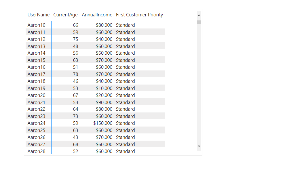

      i want to create a conditonal formatting with background color for first customer priority ( we use direct query )
      1. if currentAge < 60 and annualincome > 100,000 – priority should be green
      2.if currentAge between 60 and 70 and annualincome between 60,000 and 100,000 – priority should be orange
      3.if currentAge between > 70 and annualincome < 60,000 – priority should be red

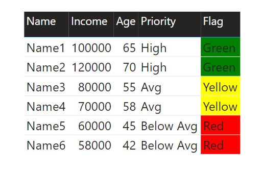

      You can use Switch Conditions together as below. You can just the conditions as per your requirements. Uploaded the file as well.Ā
      Flag =
      SWITCH(
      TRUE(),
      Emp[Income] >= 100000 && Emp[Age] >=60, “Green”,
      Emp[Income] >= 70000 && Emp[Age] >=55, “Yellow”,
      Emp[Income] >= 50000 && Emp[Age] >=40, “Red”)
