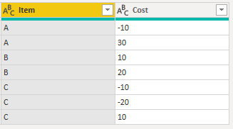

      I am trying to find a way to solve below problem :
      Lets say I have a table as shown belowĀ
      Now i am trying to convert this table into below table ( Positive and negative in separate columns but same row )
      Tried multiple conditional custom column but not yet solved .
      Please let me know for any solution to this .
      Prabhat

      You can use the conditional column to separate the positive and negative items then pivot this column to aggregate the rows. See below with some additional scenarios to handle summing multiple positive or negative values.
      Result
      ?See attached pbix.
      ?Colin.

      Thanks Colin !!!
      It solution has worked for my dataset
