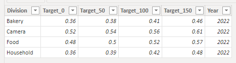

      I have target table ,that is having targets based on each division for this year
      Division Target_0 Target_50 Target_100 Target_150 Year
      Bakery 0.36 0.38 0.41 0.46 2022
      Camera 0.52 0.54 0.56 0.61 2022
      Food 0.48 0.5 0.52 0.57 2022
      Household 0.36 0.39 0.42 0.48 2022

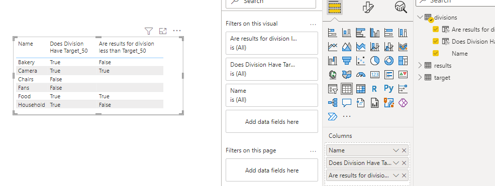

      Based on what you described, I tried to create what I think your data and model look like.?Ā  I think you have three tables like so:
      Division:
      Target:
      Results:
      And the data model might look like this:
      In that case, you could add two calculated columns to the Divisions table, that would have formulas like this:
      Does Division Have Target_50 =
          NOT(ISBLANK(RELATED(target[Target_50])))
      Are results for division less than Target_50 =
          IF(
              divisions[Does Division Have Target_50],
              IF(RELATED(results[Value]) < RELATED(target[Target_50]), "True", "False"),
              BLANK()
      And then you can create a table visual to show the results:
      Hope that helps.Ā  Please consider posting your ,pbix file, and we will be able to give you a more customized answer.
