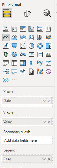

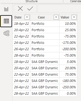

      I think the primary problem is the way you have your data arranged.Ā  You currently have the values for each of the two lines in separate columns; instead you need to actually have them in the same column.Ā  Your data should look like this:?
      Then, you can create a simple line chart visual, by placing the Date on the x-axis, the Value on the y-axis, and the Case in the Legend:
      And you should get the chart you want:
      Hope that helps.
