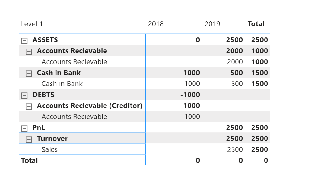

      I am stuck on a balance sheet model issue.
      Here is a simplified example :Ā

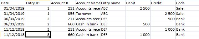

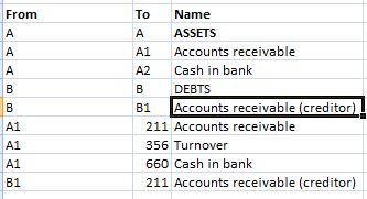

      – I have 3 tables :
      1) Accountancy entries
      2) Trial balance with a code matching the account number with the balance sheet codes
      (relation with table 1 between columns “Account #”)
      3) Balance sheet hierarchy
      (relation with table 3 between columns “Financial statement Code” & “To”)

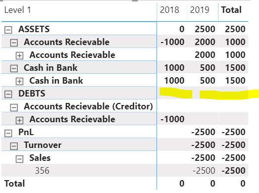

      – The aim is to get the following report (with drill down from Asset/Debts level to accountancy entry) :
      As you can see, the field “Accounts receivable” can appear both in assets or in debts depending of the YTD.
      If the YTD is positive like in 2019 (our clients owes us money), it appears in assets while if its negative like in 2018 (advances received from clients), it will appear in debts.
      I tried many solutions without success :
      – I don’t see a measure working since I would lose the ability to drill down to the accountancy entries and I also lose the hierarchy subtotals.
      – I tried to make relations between 2 columns in table #2 and tableĀ  #3 but it won’t work. Also, I would have to have as many table as year since the reporting position (between Assets/debts) might change every year.
      Many thanks in advance for your help !

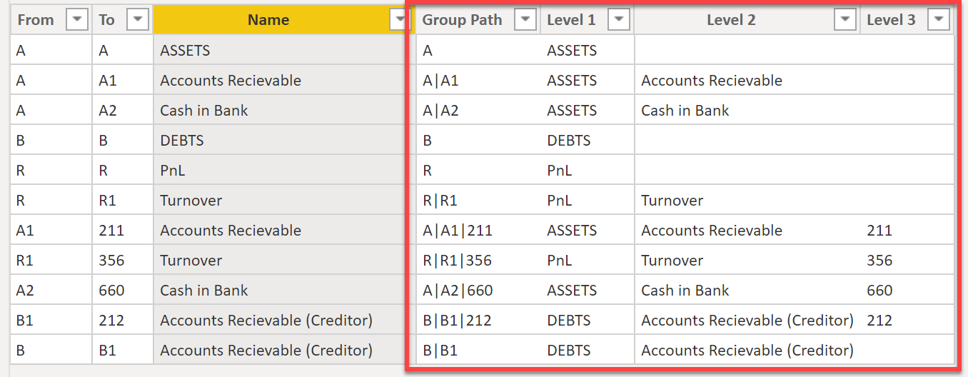

      However, to achieve the above, there are some changes to be made to your data model. I am not sure whether these changes will be allowed / possible in your environment. The solution is subject to this.

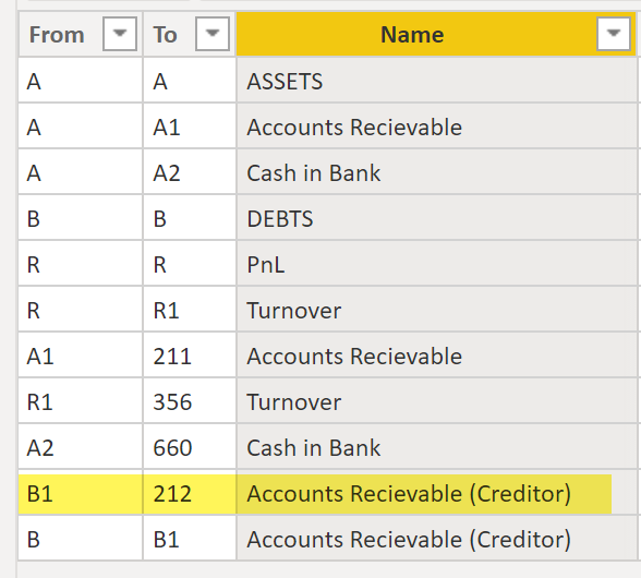

      1.Ā In the ‘Balance Sheet Hierarchy Table, you will need to classify the alternate account – ‘Accounts Receivable (Creditor) as a separate ‘To’ value as shown below (that is the ‘TO’ column should have unique values):
      2.Ā Then, you will need to expand this table with additional calculated columns for the proper hierarchy as below:

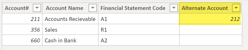

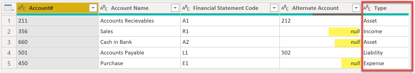

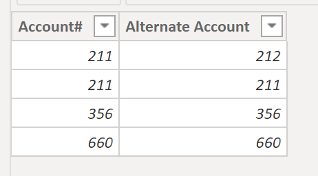

      3.Ā You must add an additional column for the alternate account in the COA table:

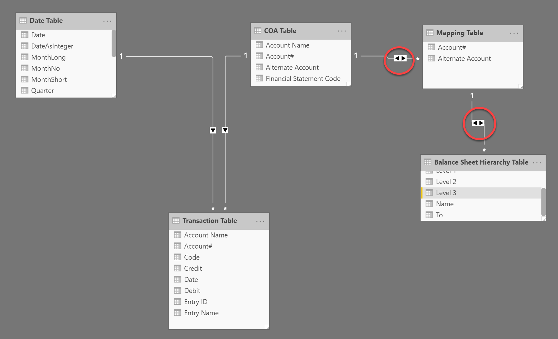

      4.Ā You have to create a new mapping table in the following format:
      5. Create the relationships:
      6.Ā Finally, the measure for the total GL amount:

              CROSSFILTER ( 'COA Table'[Account#], 'Mapping Table'[Account#], BOTH ),
              CROSSFILTER ( 'Mapping Table'[Alternate Account], 'Balance Sheet Hierarchy Table'[Level 3], BOTH )
      If this is a working model for you, you can use the same process for other accounts which needs the same treatment.

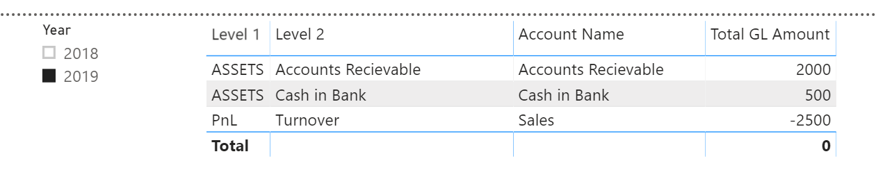

      In both case, the setback is we lose the hierarchy in the process (and the subtotals in level 1 & 2).
      In your PBIX file, the debts total is gone since PowerBI isn’t able to find the hierarchy. (Alas, I absolutely need to have a total of assets/debts)

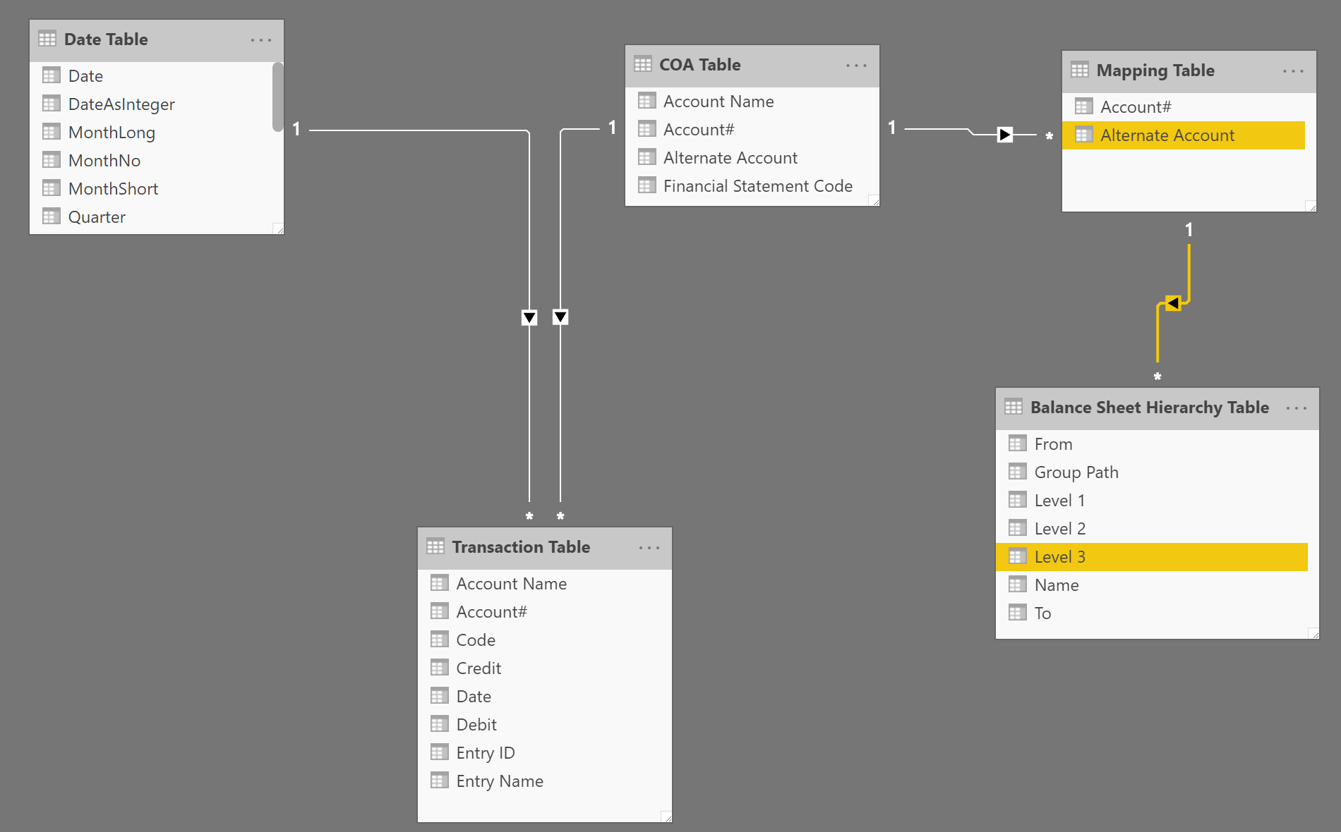

      And a change in the relationship:

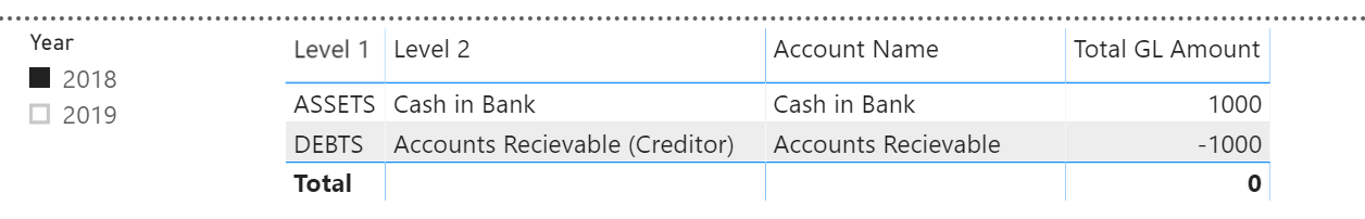

      Unfortunately, this edit generates a null total asset in 2018 (instead of 1 000 for the cash in bank) & a null debt in 2019. It seems we can’t have both the assets & debts totals right at the same time.
      As for the measure on 2 columns, I can’t seem to make it work on your model yet. I will work on it this week-end and hopefully can send it to you. But, I think your way is more elegant.

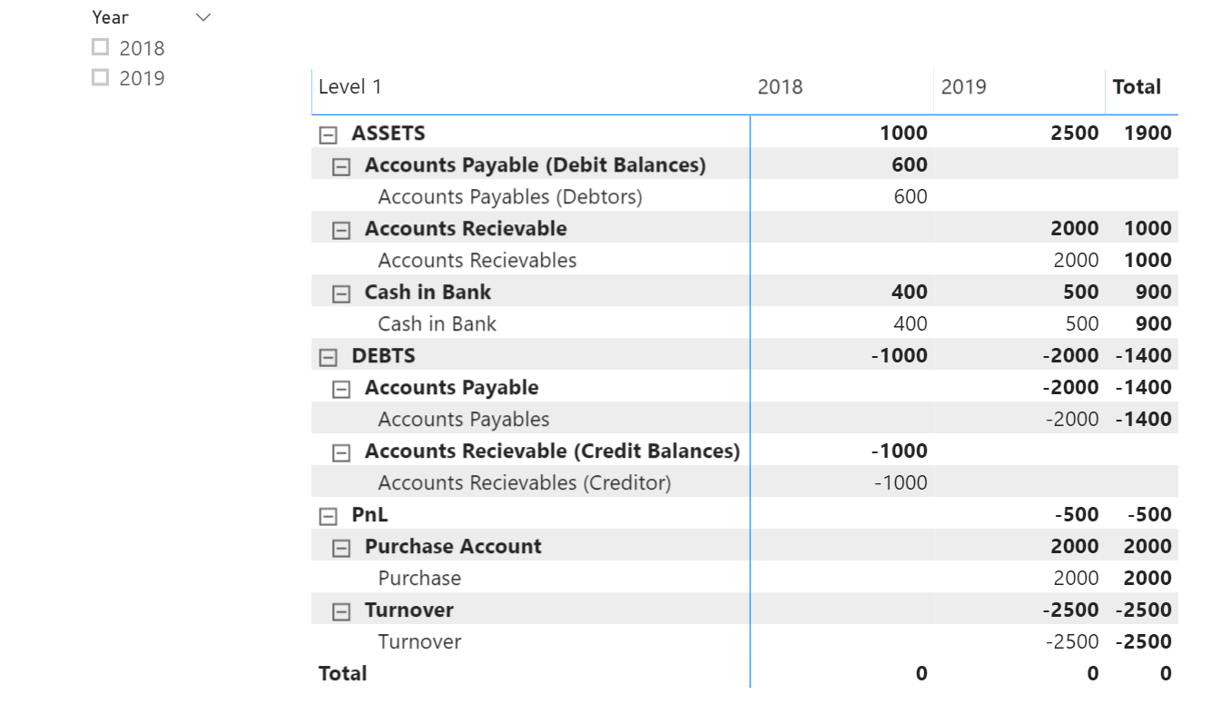

      Please see if the following helps you. In the worked-out example, I have included a case where an Accounts Payable becomes debit and shown on the Asset side.
      There are some changes to be made:

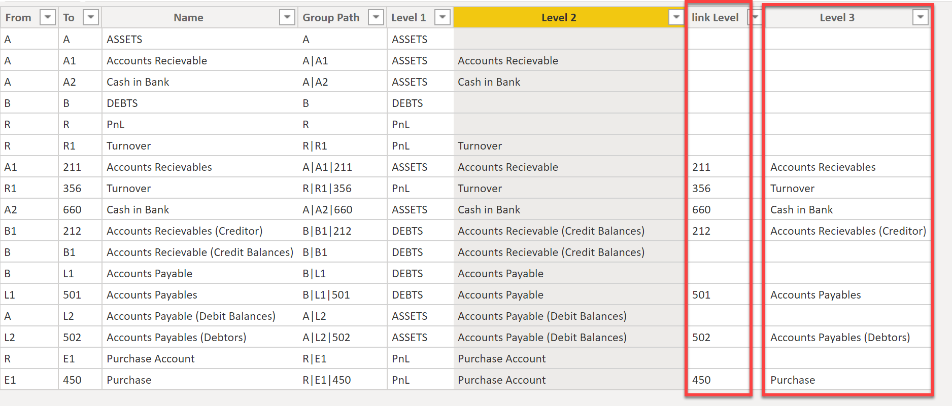

      1. You will need to add a ‘Type’ in the COA table to identify between Assets, Liabilities etc. This will be required to generate the correct alternate account. Also, ensure that the alternate account is ‘null’ if there are no alternate account (I have forced null in query editor):
      2. Create a new column for [Link Type] in ‘Balance Sheet Hierarchy’ table and change the level 3 formula to give the text in level 3;

      3. Ensure that you use the hierarchy levels from ‘Balance Sheet Hierarchy’ table to build your matrix visual;

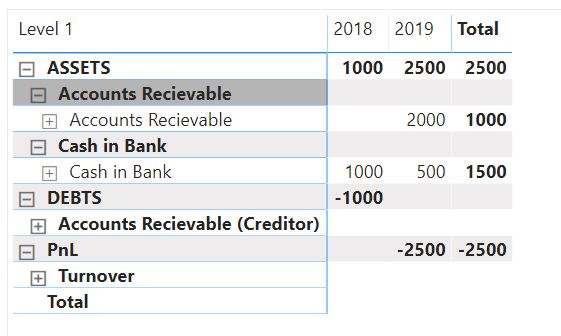

      In the meantime, enclosed, is a partial solution I came up with yesterday :
      1- I am creating an additional table (called virtual table) where I duplicate all accounts with a column “Type” to distinguish between Debit and Credit with the UNION function.
      This allows me to join this new table with the balance sheet table.
      2- I created a measure that will sum the Transaction table entries depending on wether the account total is debtor or creditor and on the date.
      It seems to do the trick :
      However, I still have a few issues when testing with a more complex set of datas : the drill down the to transaction entries can be wrong. The limitation is that a debtor balance will correctly appear in the assets. Yet, the balance is comprised of debtors & creditor entries. So, when drilling down to transactions entries, the individual creditor entries will appear in debts.
      Also, this might not be the most efficient way to do it.
