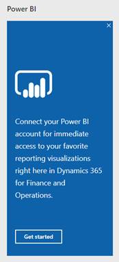

      I am try to enable embedded power BI reports in Dynamics 365 FO. After creating an app in AAD and granting the permissions and all, I moved to the step of enabling Power BI in Dynamics. I entered the app ID and key. I moved then to this interface to get started with Power BI.
      I am encountering a problem of authentication between Dynamics 365 FO ( sandbox environment ) and Power BI azure app.
      I have read any related posts and documents. I did see some people have same issue but didn’t see any solution posted.
      Can anyone help?

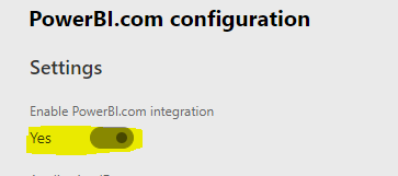

      I have resolved it. The resolution is disable and re-enable the integration(see following screenshot). I still don’t know why doing this it fixed the issue. But it worked. my guess is this is a bug.
